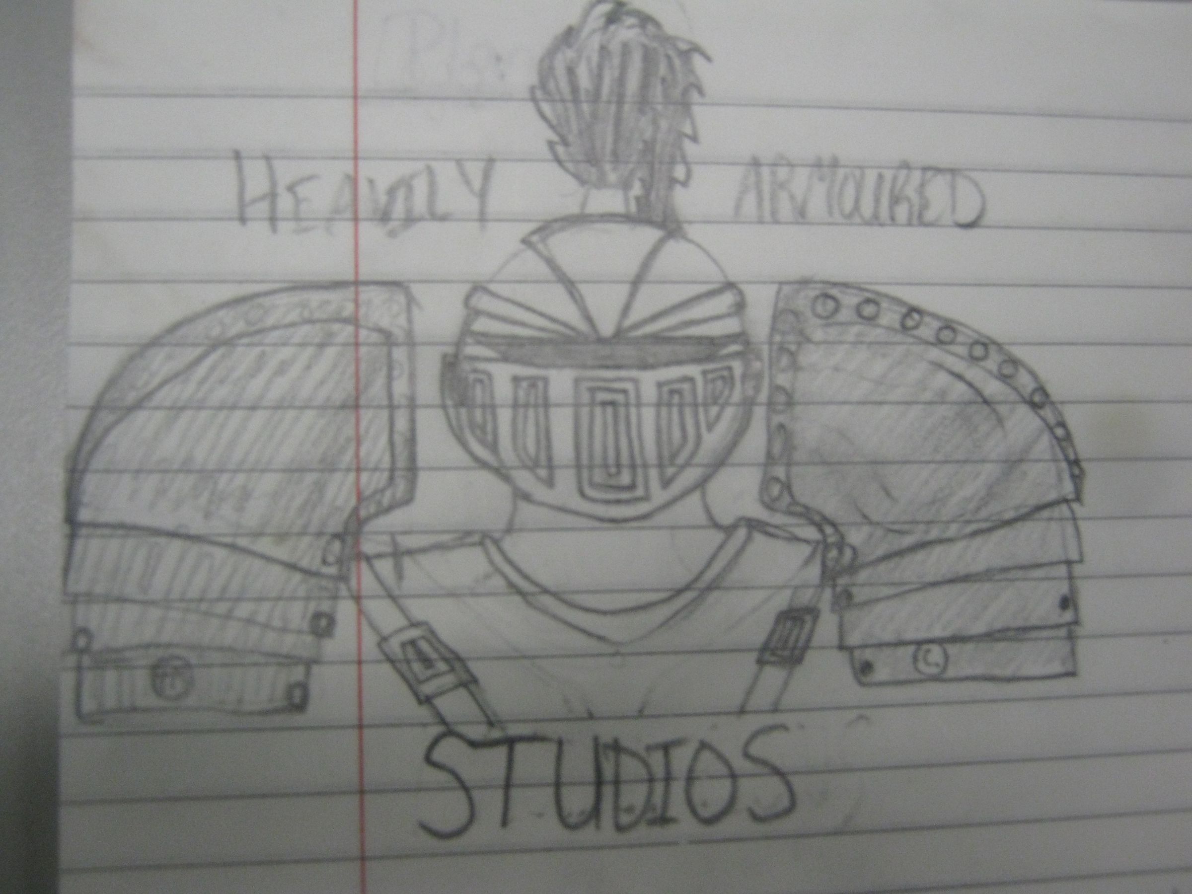

First, you've got to import each individual component of you're animation that you want to animate. In this Instructable I will be using the logo of my business, Heavily Armoured Studios. In this case, I exported the files individually, the Helmet, both Shoulders and Chest at once, (Which I drew in Adobe Illustrator) so that the two shoulders could glide across the screen into the suit of Armour. *An easy way to Illustrate your drawing on the computer is to scan your image and save it, and import it, tracing over-top of it.
