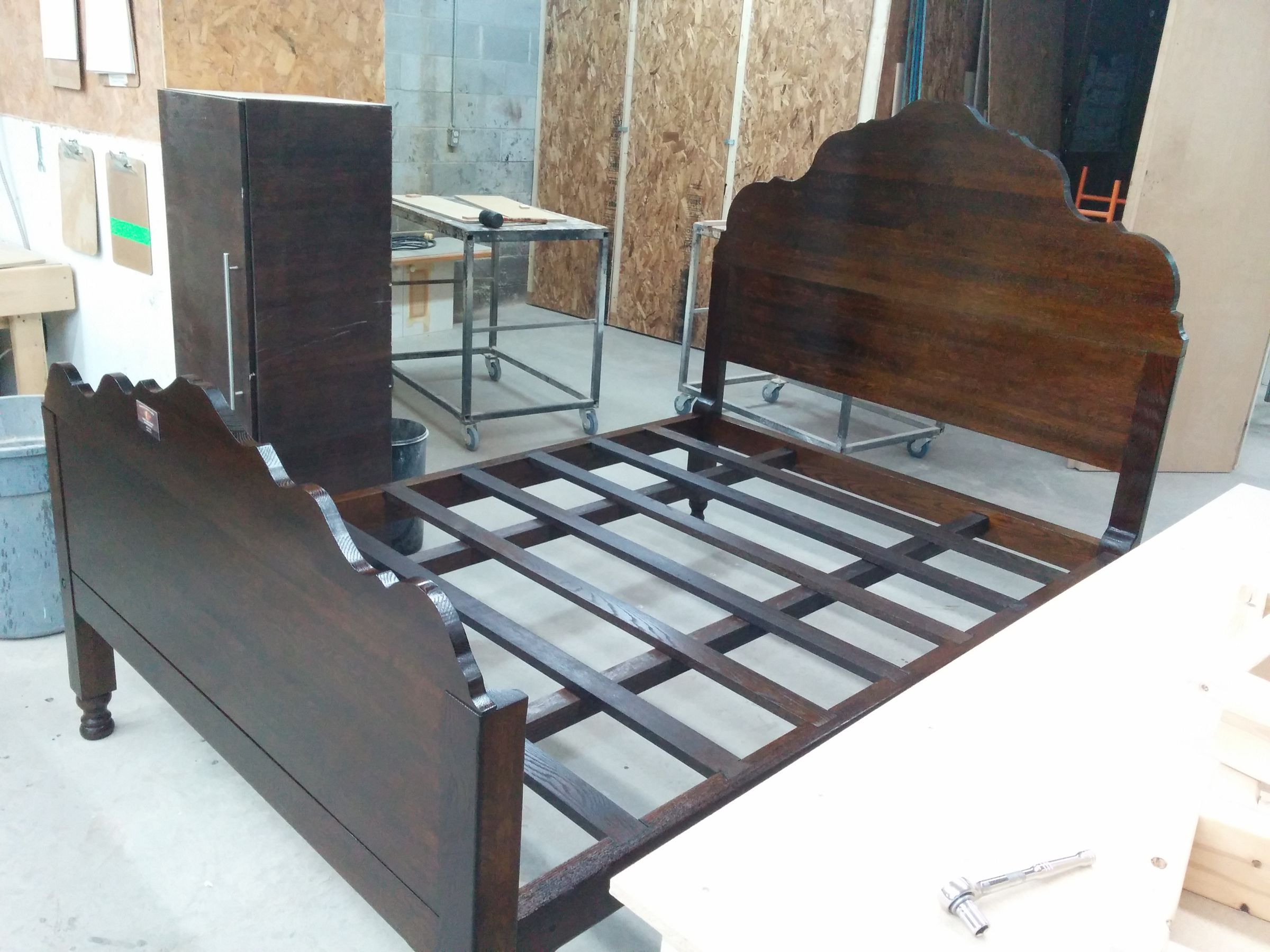

Step 21: Enjoy
You've done it! you made a cool and unique piece of furniture. Be proud!
Now every time someone looks at it and says wow! You can say I made that. and if they say WTF? then say I know, F-ing Ikea right?
