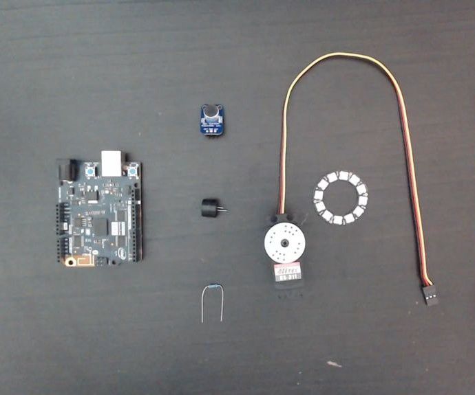

Step 5: Order the Electronic Components
Step 6: Assemble Everything Together
Now, it is time to create the electronic circuit and assemble our Robot. This step is quite straightforward!
Because we have previously created the 3D model of the Robot with the electronics already integrated in the upper body, we know exactly where each electronic component goes. We just now have to create the complete electronic circuit by connecting the sensors/actuators to our Arduino/Genuino 101 board and then place the board and components in the upper body of our robot.
