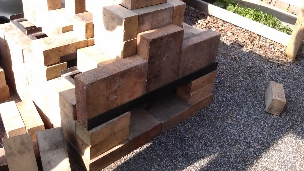

On top of the first layer, start laying out the firebricks into a square floor that is 5 bricks wide by 10 bricks deep. If your firebricks aren't of standard size, you want the floor area to be square and close to 4'x4'. A few inches short is OK.
Take the 4' angle iron pieces and drill a hole at each end, large enough for the threaded rod to slot through, but small enough that the nut can be screwed against it without going through it. We'll use these metal pieces to hold the sidewalls in place. Place two of them on the floor of the oven, one on the right and one on the left side.
Assemble the side walls by standing bricks on their sides, placed on top of the angle iron that runs them the length of the floor. Starting from the back, put thirteen bricks on each side (see photos for positioning). Add one layer of bricks on their side on top of that layer..
For the back wall, stack bricks on their sides in a staggered pattern. You'll need to break a few bricks in half to have the back wall sit flush with the sidewalls. Go six levels tall and on the last level, leave the sides open as the roof will start arching in here.
Once you have the sides in place, you can put the other two angle iron pieces on top of the bricks and slide the threaded rod through the holes. Screw the nuts into place but don't lock it in yet, in case you have some adjusting to do.

Place the jig at the back end of the oven, against the wall. Put a thin (1/4" or less) shim under each leg.
Starting from the outside, add the bricks on their sides, moving inwards from each side. The middle brick (keystone) ended up fitting perfectly into place. Break one of the firebricks and use the shards in between the gaps to keep them from shifting and falling during the jig removal.
Once the arch is in place, you want to gently slide the shims out from underneath the legs. The jig will drop down and the bricks will settle a bit. At this point, you can gently pull the bottom of the jig towards you to slide it out from the bricks. If everything was done correctly, they should remain in place. I have never seen this not work, but still, do it gently.
Watch the attached video for a demonstration.
Once the first layer is done, repeat for two more - the arch ceiling is three brick lengths long.
