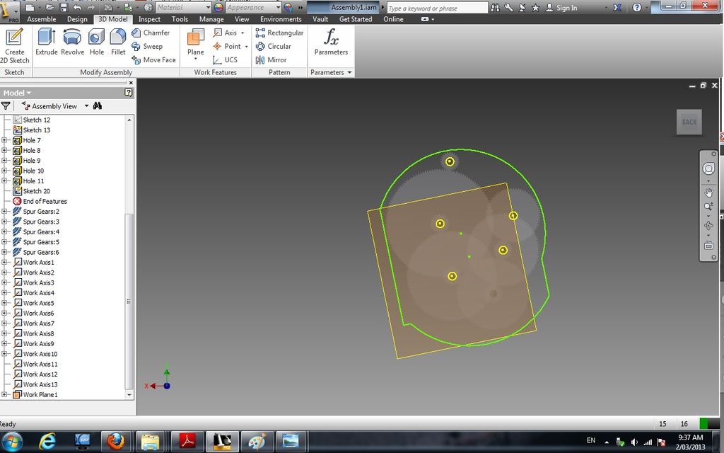

Once your gears are in their final position create a new work plane offset from the surface of one of the gears. This will be the surface upon which you will create the shape of the gear box housing. You may simply draw a rectangle around all of the gears or for a more efficient and elegant design you can create a contour around the gears. This is the process that I used.
Create a new sketch on the surface you created and select "Project Geometry". Click on each of the holes of the gears to project this shape onto your work surface. (See second illustration.)
Once you have projected the holes in the gears onto your work plane you can create circles centered upon the middle of each circle. (See third illustration.)
Now join the circles with tangential lines. (See fourth illustration.)
Now use the "Trim" tool within the "Modify" group and select all line segments that exist inside of the contour of the shape you have created. (See fifth illustration.)
The last step in building the contour of the panel is to create a straight segment at the bottom that we will attach the piano hinge to in order to rotate the plane of rotation to align with the planetary polar rotation. To do this rotate your drawing until the shape is aligned to your preference. After doing this create a rectangle that aligns with the furthest points along the perimeter of the panel. (See sixth illustration.)
The last step in creating the contour of the panel is to trim the remaining interior lines. (See seventh illustration.)
Once the contour is defined you need to modify the projected hole patterns to match the outer diameter of the ball bearings you are using. In my case I used ball bearings with outer diameters of 1.125" and .75". (See eighth illustration.)
You should now extrude this shape to create the first panel for your gear box. Extrude this to the width of the acrylic sheet you are using, in my case 3/16".
Once you have created the first panel you must duplicate this design for the front and back panels. In the final illustration on this part you can see how the panels align with the gears as well as the axles that connect the gears.
