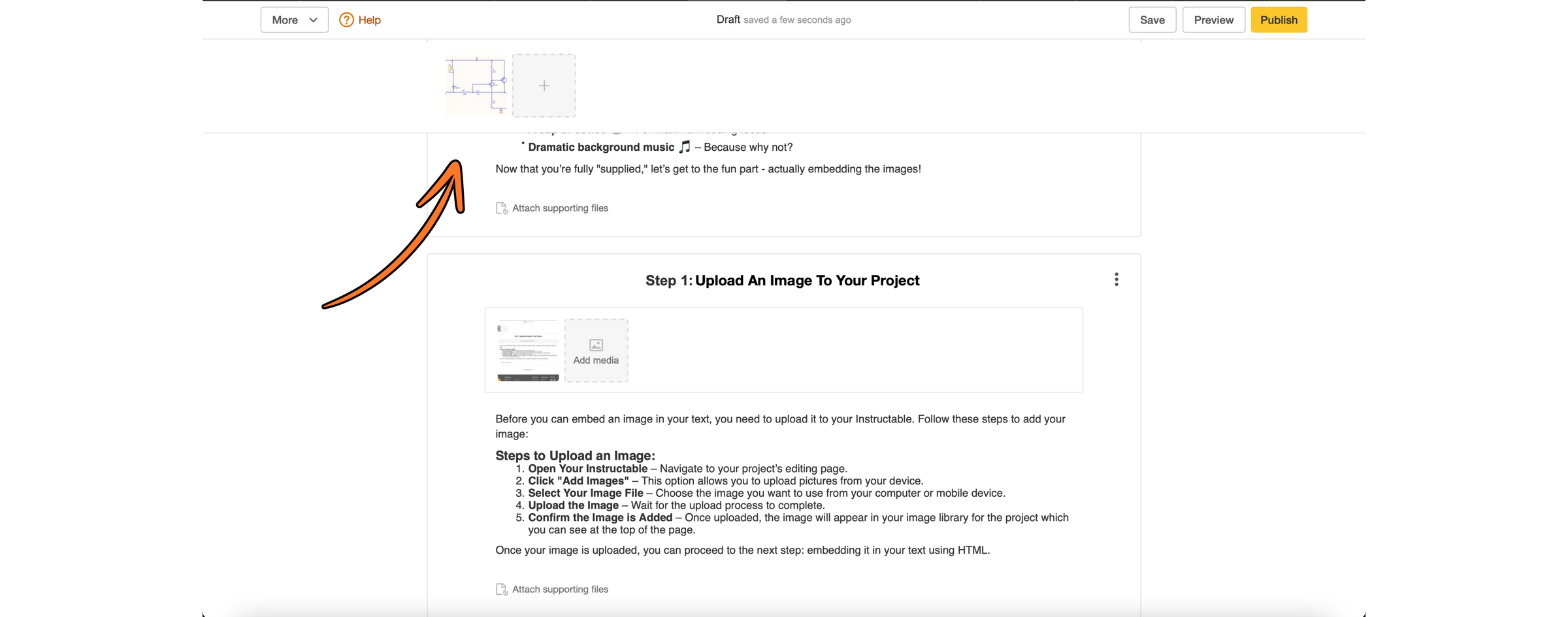

Step 1: Upload an Image to Your Project
Before you can embed an image in your text, you need to upload it to your Instructable. Follow these steps to add your image:
Steps to Upload an Image:
  1. Open Your Instructable – Navigate to your project’s editing page.
  2. Click "Add Images" – This option allows you to upload pictures from your device.
  3. Select Your Image File – Choose the image you want to use from your computer or mobile device.
  4. Upload the Image – Wait for the upload process to complete.
  5. Confirm the Image is Added – Once uploaded, the image will appear in your image library for the project which you can see at the top of the page.
Finished Circuit
Once your image is uploaded, you can proceed to the next step: embedding it in your text using HTML.

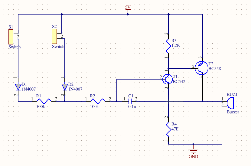

Example:
<p>Here’s what the finished circuit looks like:</p>
<img src="https://www.instructables.com/files/orig/example-image.jpg" alt="Finished Circuit">
<p>Now, let’s move on to the next step.</p>
Will look like this:
Finished Circuit
