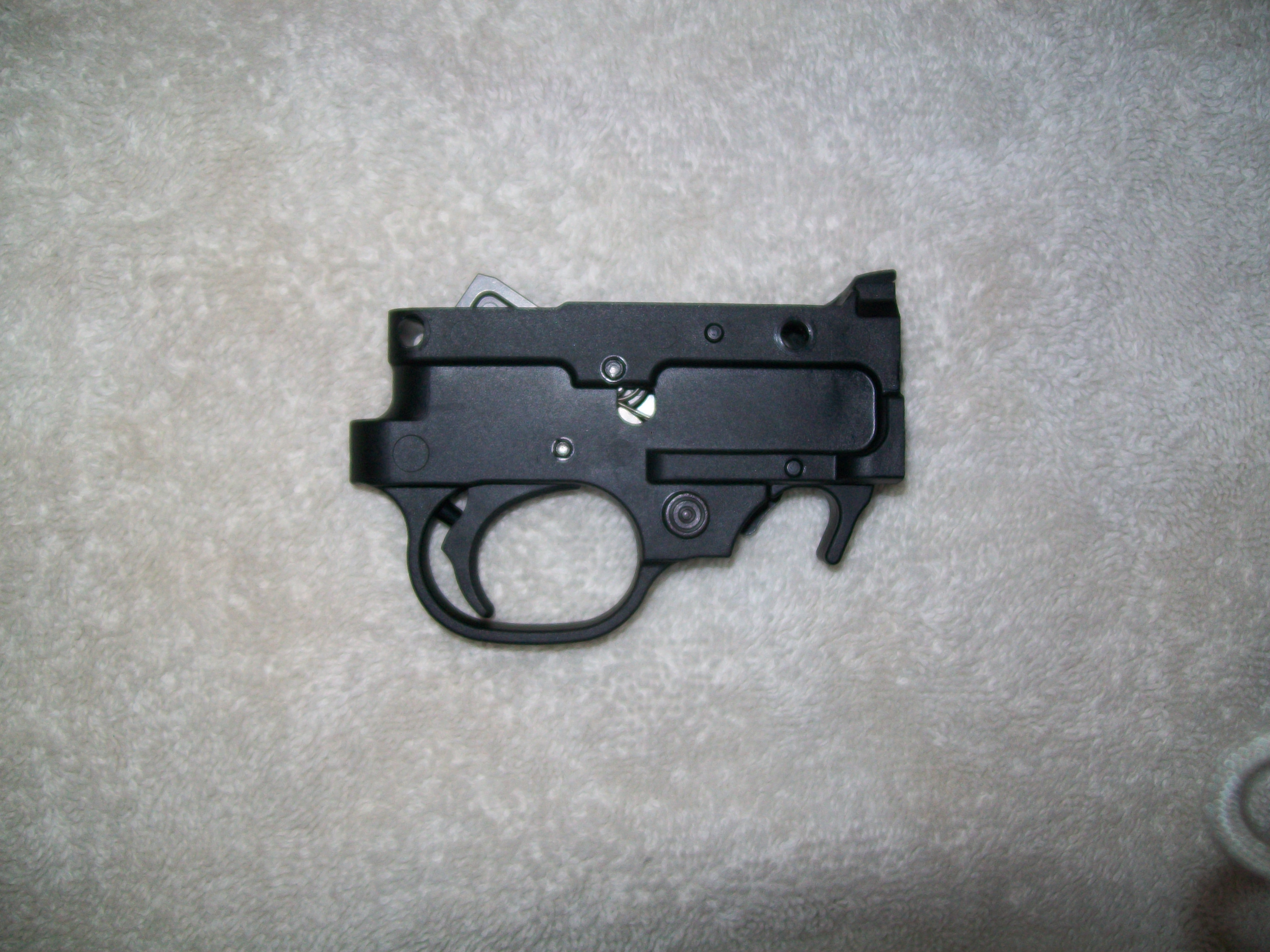

Step 3: Remove Pins
Depending on your rifle, the pins may just fall out on their own, or they may need some help. If they don't come out easily, gently use the screwdriver or punch and a hammer and gently tap the pins out. Put them somewhere where they won't get lost. Don't let the pins come out of the trigger assembly, unless you want to. I show how to disassemble the trigger assembly here: www.instructables.com/id/How-To-DisReassemble-the-Ruger-1022-Trigger-asse/
Step 4: Remove Trigger Assembly
Take the trigger assembly out and put it aside.
