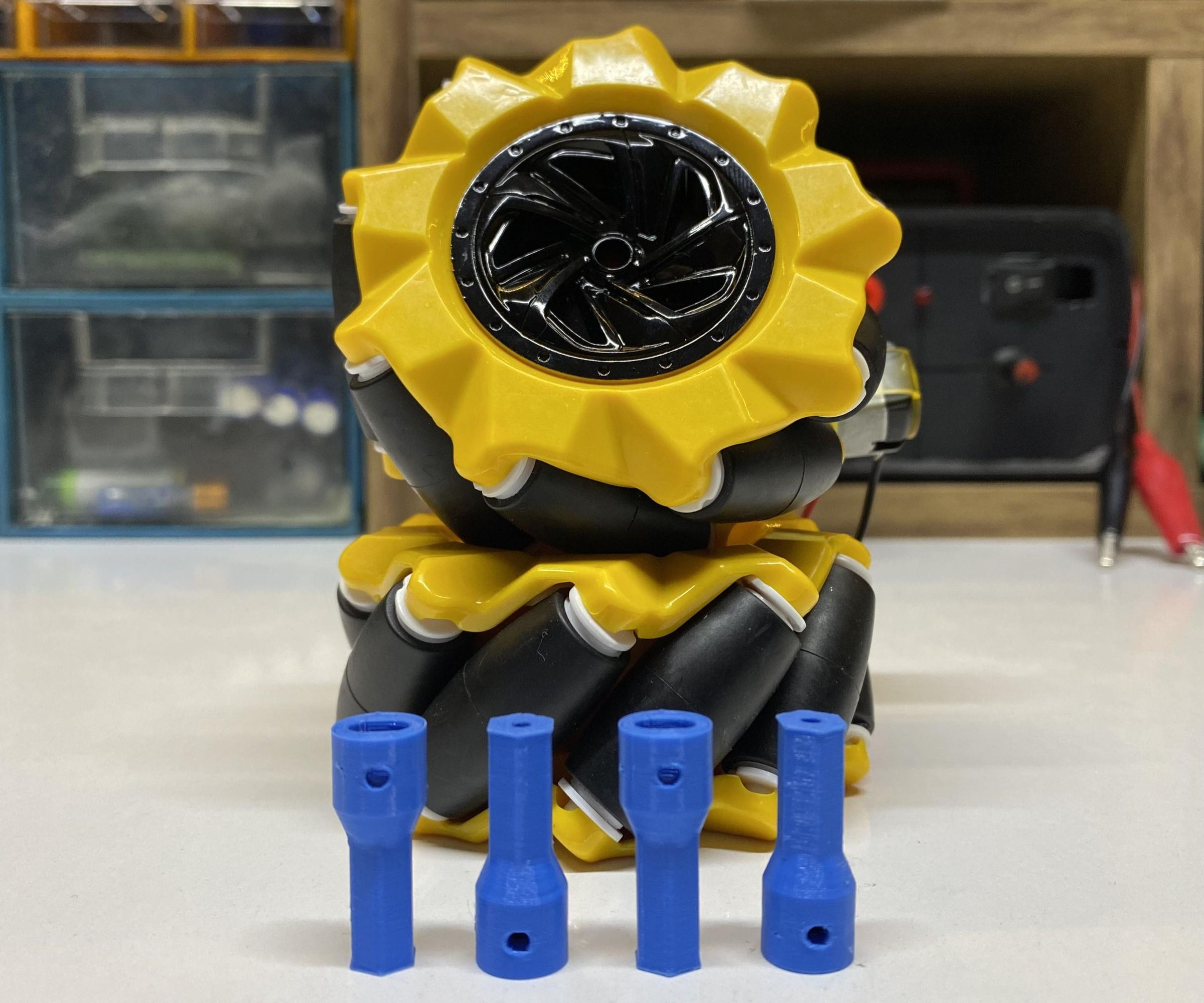

Final: As a result of these operations, when our printer reaches the number of layers we have written in the "Layer" section, it will stop printing and come to the home position. Here, our task will be to remove the existing filament, insert the filament we want to print, and continue the printing. I left a few print images below that were not taken from the plate. Aren't they beautiful… 🙂
