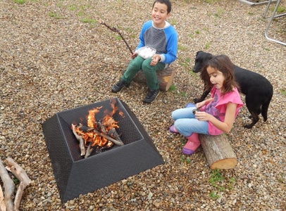

How to Make a Cool and Compact Fire Pit From Half a Sheet of Steel
cammers 'profile picture'
186K1.1K113
Intro: How to Make a Cool and Compact Fire Pit From Half a Sheet of Steel
Hello Instructablers.
I'm really taken with fire pits at the moment. I think it's because fires are such a natural social thing for humans. They have been at the centre of our social lives for tens of thousands of years. There are sites in Northern Australia where the remnants of camp fires show continuous use of more than 40,000 years - art on the adjacent rocks depicting long-extinct megafauna and Europeans on horseback. I think we all have a genetic memory of socialising in this way, and that's why we all feel so comfortable doing it.
I would like everyone to be able to enjoy a fire, but my last fire pit was a bit too big for a lot of back yards so I have come up with this new - more compact - design.

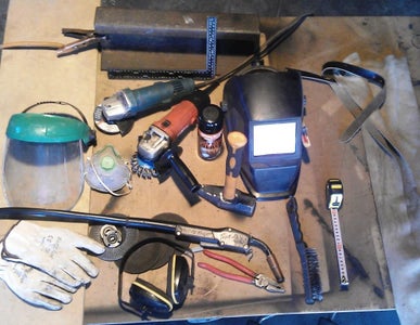

This one is made from half a standard sheet of 2.1mm chequer plate. Any steel plate of about that thickness will do. The overall dimensions of the sheet you need for this design are 1200mm x 1200mm. Of course you can adjust the design to suit the materials you have at hand. There is no need for a separate stand for this fire pit. It is all one piece.
Here's a guide to what you'll need:
  • 1200mm x 1200mm 2.1mm chequer plate
  • Tape measure
  • Boilermakers'chalk and a straight-edge.
  • A welder. I'm lucky enough to have a great old mig.
  • An angle grinder or two with cutting discs, flap disc, grinding disc, and wire brush.
  • A hammer
  • A drill for cutting drain holes.
  • "Pot Belly Black" paint. Or any heat resistant paint. Or no paint at all for the rusty rustic look.
  • Safety gear: gloves, ear muffs, eye protection, etc. Boring but necessary.

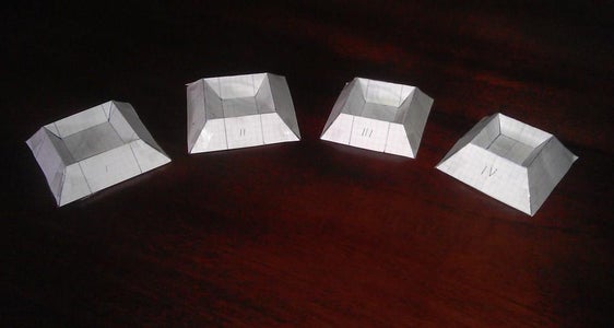

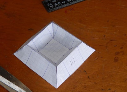

I wanted to make a more compact fire pit that would be suitable for smaller yards. I had an idea that I could make a self supporting fire pit from a single sheet of steel, but I couldn't really picture how it would turn out. The simple solution was to make some simple models from graph paper and compare the results.
Of course you can use the same technique to make your own design. If you do please post a picture in the comments.
You can see from the pictures that I chose model III and then it was a very simple process to transfer the dimensions from the graph paper to the steel plate. The heavy lines in my sketch are cuts, and the light ones are folds. Mark all these on the smooth side of the steel plate as shown.

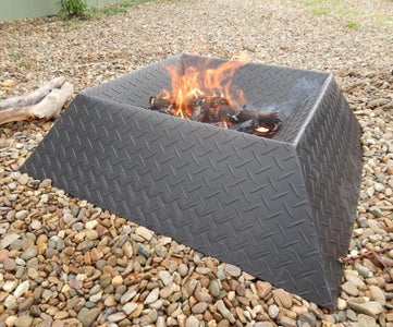

STEP 9: Conclusion
You now have a fire pit that you can be proud of. Fill it up with wood and fire, and get some friends around (make sure one of them has a guitar and knows how to use it), and load them up with beer and food. There is nothing better that sitting around a fire with a bunch of good friends.
