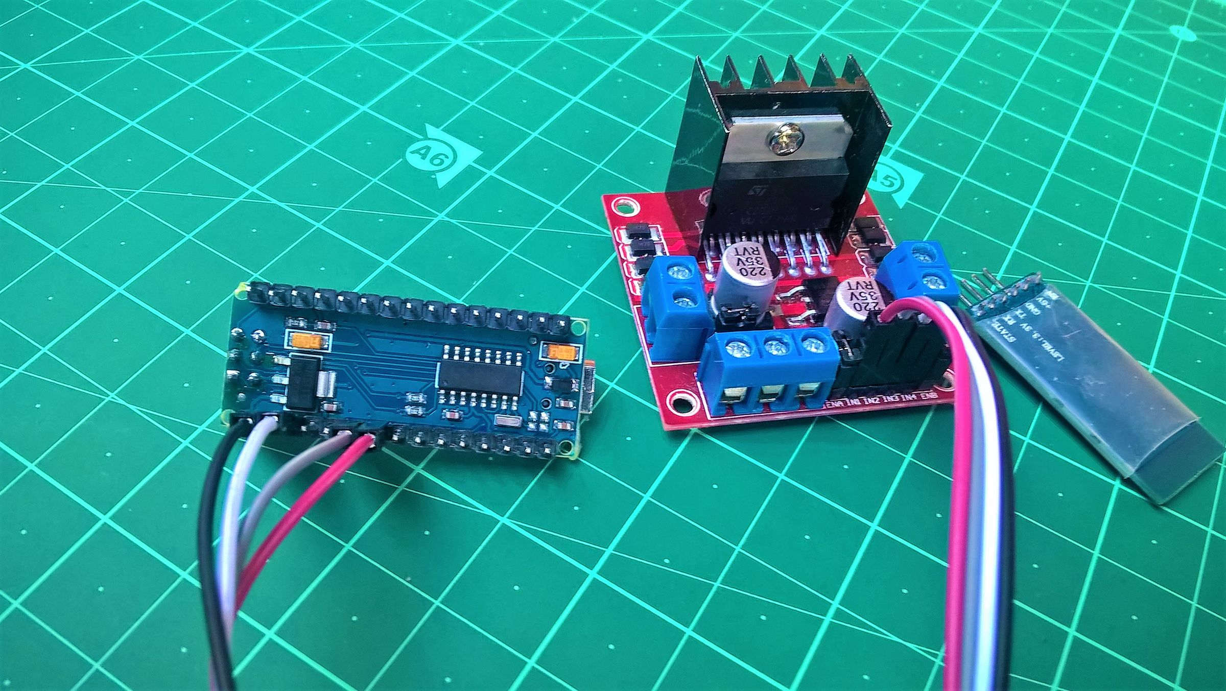

Step 1: The Parts List
Here's The Parts List:
  • Arduino Nano
  • L298N Motor Driver
  • HC05 Bluetooth Module
  • 18650 Li-ion Battery(2ps)
  • Old RC Car
  • Male To Female And Female To Female Jumper.

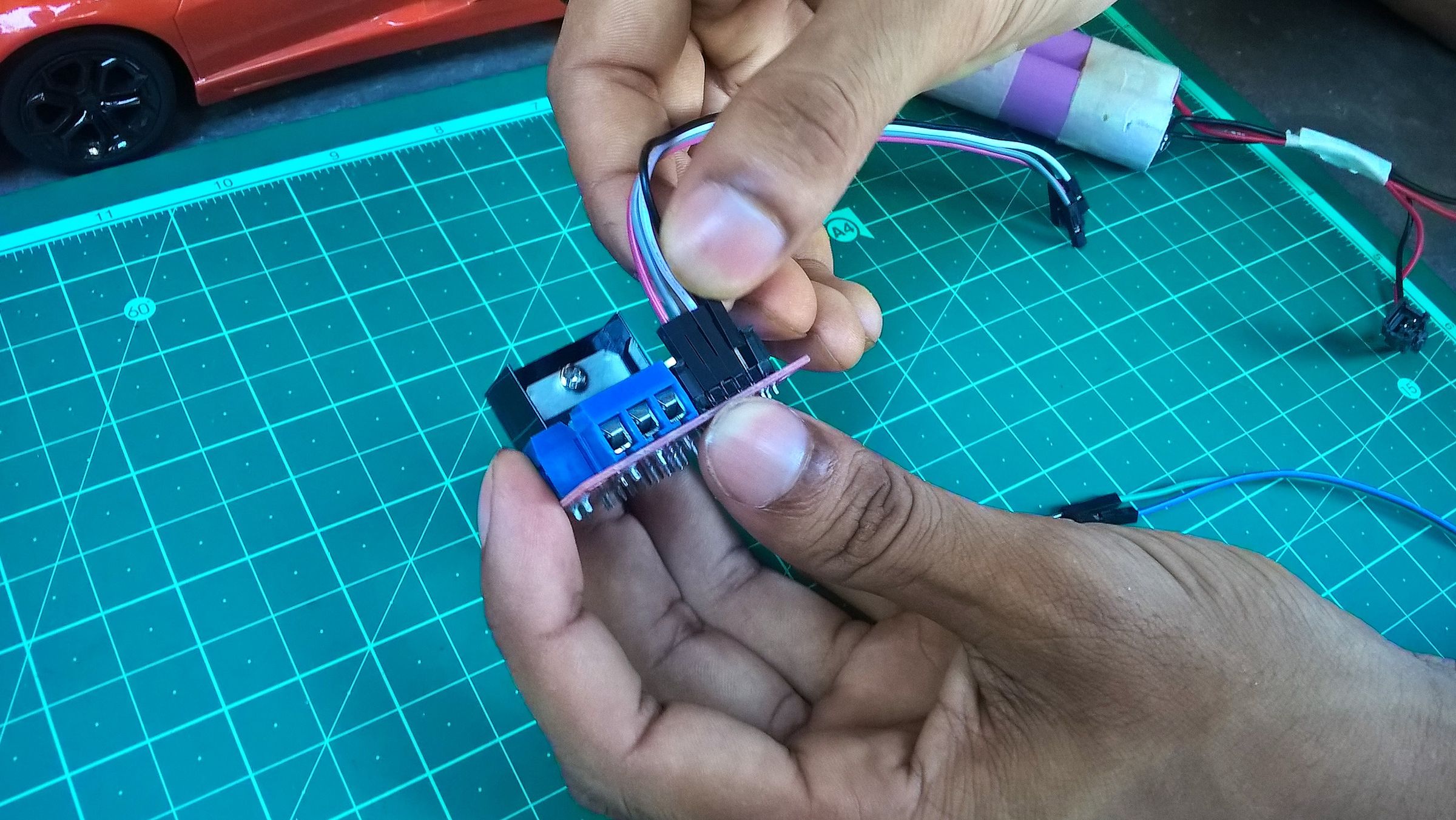

Step 5: Connect All the Modules
First, we'll start off by making the connection among all the modules. At first, connect jumpers between motor driver and Arduino as follows.
*Arduino--Motor Driver
  • D5>IN1
  • D6>IN2
  • D10>IN3
  • D11>IN4
  • Vin>5V OUT
  • GND>GND

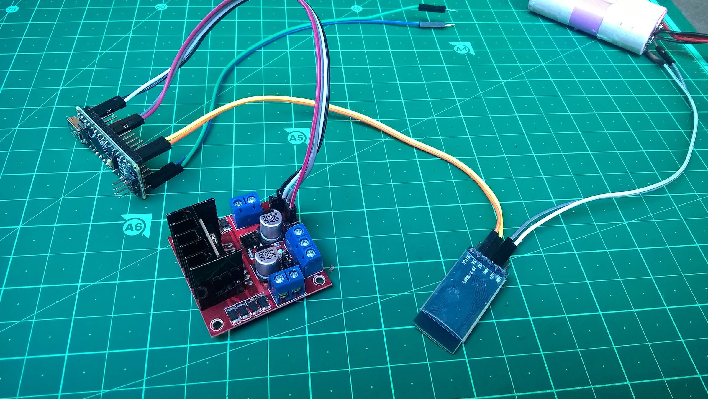

Now Connect Bluetooth Module TO Arduino And Motor Driver
*Arduino--Bluetooth Module
  • TX>RX
  • RX>TX
*Motor Driver--Bluetooth Module
  • 5V OUT>5V IN
  • GND>GND
