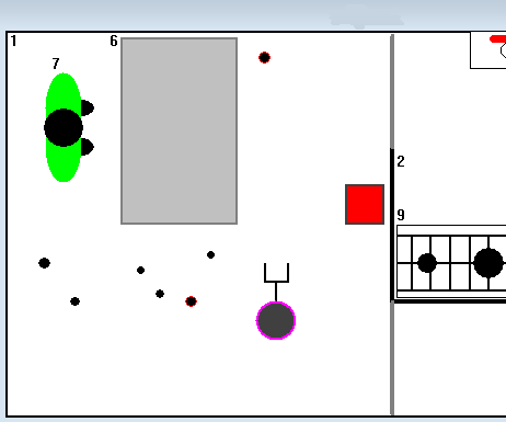

NB implements a virtual machine with an associative processor. RobOS runs on this machine and concentrates on the outer world rather than on the inner parts of a computer. The principle is the same. When you use a function which writes a variable into a disk file, you don't bother about cylinders and sectors where data will be stored. Likewise, when you tell robot: "put box on table.", you don't specify where exactly. It is RobOS that must handle details for you.
Step 2: Find HOME_ROBO.SCP.
It implements a servant robot operating in a virtual flat. Its main assignment - to bring various things to the user. The algorithm for each task may be rather sophisticated. The robot must find the path, open necessary doors, and of course it must perform actions in the proper sequence. All this is computed automatically. The file is in the subdirectory RSanbox. It is well structured for better understanding and full of useful comments. They begin with '%' character an run till the next '.' (full stop). Let's look what is inside.

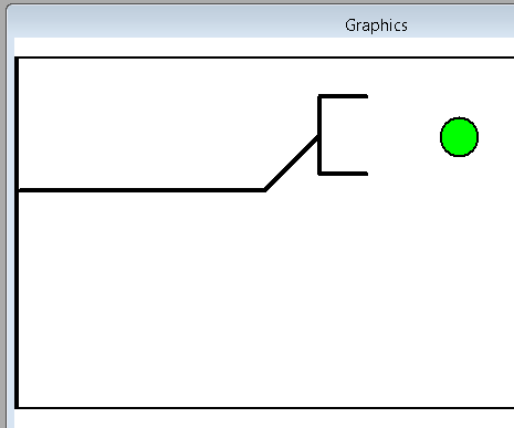

Step 7: How to Run the Application.
After installation, double-click the WinNB icon and run the program. Use the menu Browse\Command\Notebook. You will get the screen shown in the Step 1. Click in the Command window, then open HOME_ROBO.SCP from the RSandbox subdirectory.
If you installed it as RSandbox product, there is a simpler way. You will see: "Use File\Dialogue to start." at the bottom left. Do it and you will instantly get the desired result. Now you are ready to analyze the application. As soon as you made it clear for yourself, compile it. WinNB does not load programs into operative memory, keeps them in its knowledge base on the disk and runs immediately from this location. By this reason, the previous program will not disappear when you switch off the computer and first of all you need to erase it. Set the cursor in front of 'erase knowledge.' and click 'GO' button at the left. Then, put the cursor on the next, empty line and click GO again. The compilation should be completed in a matter of seconds. Also you will see the plan of some flat in the top left window. Now you are in the section of the program which is user interface. 2 more manual actions are required. Perform them like you erased knowledge. Turn on the virtual machine. Then start the Operating System. The last action does not load anything. It is already here. Just tells the shell to use it properly. At the end of your exercises, turn them off:
