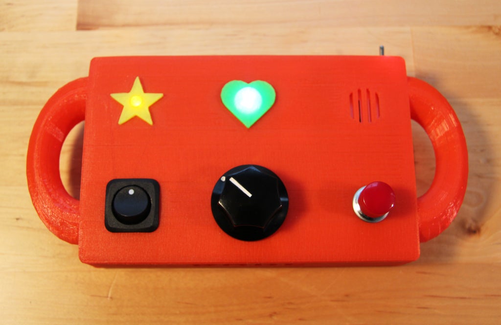

It has three different inputs and three different outputs designed to engage, develop the mind, and be fun!
The first button turns on/off the LED in the star.
The round knob changes the brightness (PWM) of the LED in the heart.
The momentary button turns on a buzzer.
When the star LED and the buzzer are on at the same time the heart LED will turn red.
You can add more complexity if you'd like, but since my nephew is only 1 year old I thought I'd start off simple.

STEP 9: Play!
Turn it on and play!
The first button (rocker switch) turns ON the star LED.
The middle knob (potentiometer) changes the brightness of the middle LED.
The momentary button turns ON the buzzer.
When both buttons are ON the middle LED turns red!
*After testing I noticed that my middle LED was brighter than I preferred, so I printed a little dome to diffuse the light. I'm attaching a .stl file in case you want to print one too.
