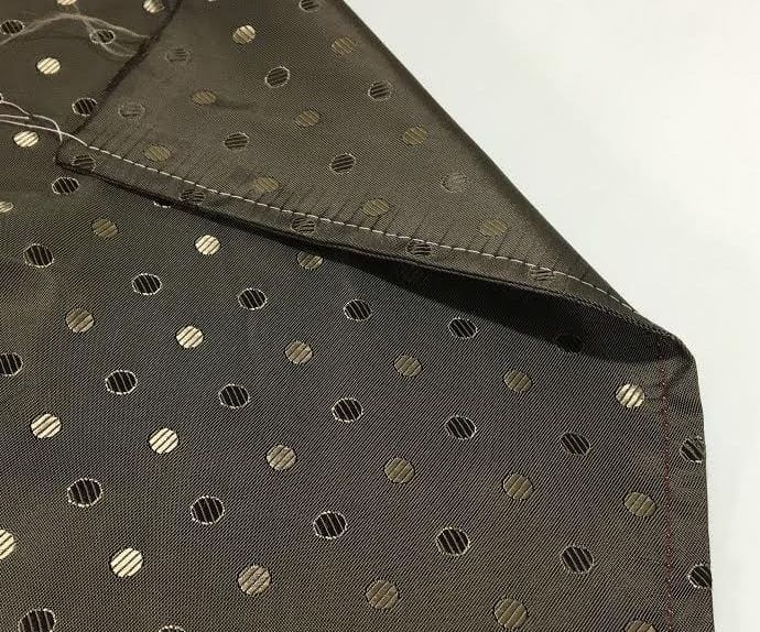

Step 8: Machine Stitch the Ruffle Seam
Making sure your sewing machine is set at a regular stitch (not a basting stitch), apply a straight stitch right bellow the bottom gathering stitch as shown in the image. You should sew as close as possible to the gathering stitch while also making sure it is placed right bellow it consistently throughout.
Step 9: Clean Finish the Ruffle Seam's Raw Edge
The ruffle is clean finished with a serging stitch. If you don't own a serger, as many sewing beginners don't, you may use a zig zag stitch on a home sewing machine. Make sure the tension balance on your sewing machine is adjusted correctly and try to sew at a denser setting for a better quality finish.
Note: It helps to iron the gathered seam allowance prior to applying a clean-finishing technique. Be careful NOT to iron on top of the actual gathers.
