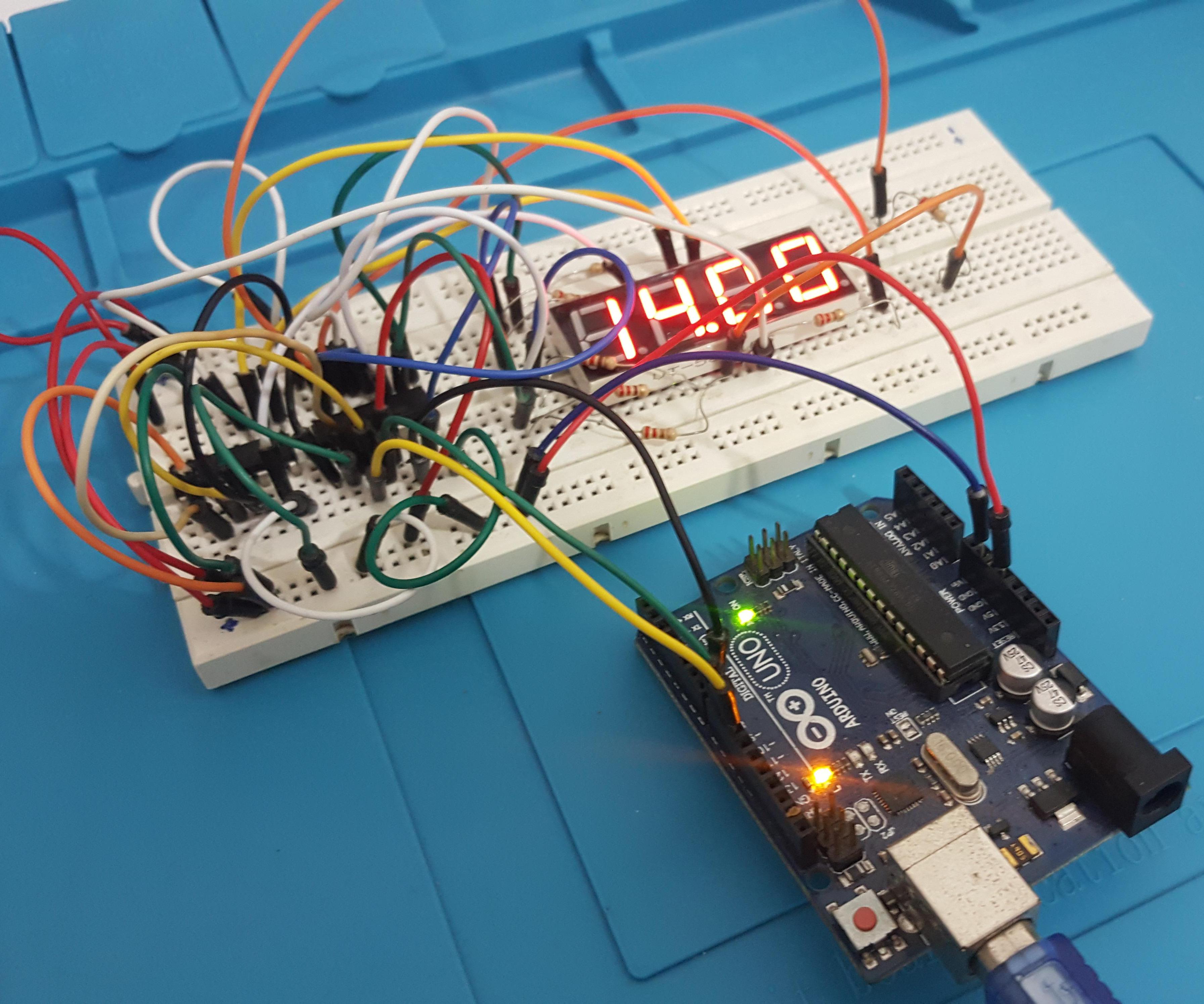

To store a float or a negative value on external EEPROM, You just need to store your float value in float variable that we defined in our union, And then just write unsigned char array members on your external EEPROM, because the memory location of these variables are the same.
For example if you want to store 34.56 value on your external EEPROM:
1: store your value in union float variable => Temp = 34.56;
2: store each unsigned char array member on external EEPROM memory location address:
x[0] => address0
x[1] => address1
x[2] => address2
x[3] => address3
It's done.
if you want to read this value, You just need to read each address from your external EEPROM and store them in our union's unsigned char array members.
For example:
addrress0 => x[0]
addrress1 => x[1]
addrress2 => x[2]
addrress3 => x[3]
And then just read union's float variable to form your data.
Also you can use this procedure to store integer values on your external EEPROM, You just need to use first two members of unsigned char array.
you can use this procedure to store negative float values on your external EEPROM too.
