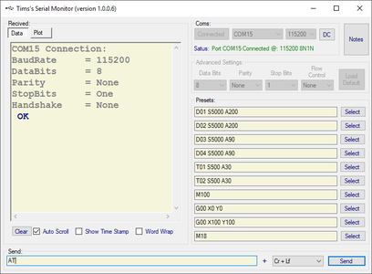

Step 6: Using a USB to UART Module
Using a USB to UART Module to make changes to the Bluetooth Module is much easier.
- I use one that has the CH340 chip.
- It is the same chip that is used on the Arduino Nano clones.
The CH340 can be powered with 3.3 volts or 5 volts.
- The module I have has a jumper to select which voltage to power it with.
- If it is powered by 3.3 volts the IO Pins will be 3.3 volts logic.
- If it is powered by 5 volts the IO Pins will be 5 volts logic.
With it set to 3.3 volts, all I need is an adapter to to connect it to the Bluetooth Module.
- I just made it out of 2 Female Pin Headers and a piece of wire
- See the circuit to see the connections.

Step 7: Changing the Settings on the Bluetooth Module
Hopefully you now know how to connect to the Bluetooth Module using one of two methods.
- USB to UART Module
- Arduino acting as a USB to UART device.
When changing the settings of your Bluetooth Module.
- It does not matter which way you have connected the Module to your Computer.
- It does not matter which Serial communications Application you use.
- The Serial Application will use the the USB COM port you have connected the Arduino or USB to UART module to.
- If using the USB to UART: The speed in the Application should be set to the speed of the Bluetooth Module.
- If using the Arduino: The speed in the Application should be set to the speed set for "Serial" in the code.
- If using the Arduino: The speed of the of the Bluetooth Module should be set in the code for "Soft Serial".
There are three things I change on a Bluetooth Module.
- The Name. This is so when I Pair my PC with a Bluetooth Module, I know which one to choose .
- The Password. I make them all the same, 1234. makes it easy to remember. If it is for special project used in the open world I may make it complicated.
- The UART Speed. usually I have it as fast as the Microcontroller and my PC will handle if HARD WIRED. But for general norm, I set it to 115200 when connecting to the Microcontrollers built in UART and 57600 when using Soft Serial on an Arduino.

Once you have connected to you Bluetooth Module with your Serial Application you are able to communicate with it.
Because we may not always know the settings of a HC-05.
- I prefer to to put it into the Special Command mode.
- Hold the button down while powering the Bluetooth Module.
- If you use an Arduino and become more familiar with the HC-05 you may want to add code to the Arduino to use a pin on the Arduino to set this pin HIGH or LOW.
Commands:
First we send AT
- We should receive OK
- If we was to send AT+ followed with a command, usually the reply would look similar to the command sent with the addition of some info.

Step 14: Controlling a Device With a Bluetooth Module
Here I have shown a flow chart showing a computer communicating to a Bluetooth Module.
Here we are using the built in Bluetooth of the computer.
- The serial Application is connected to the Virtual COM Port created when a Bluetooth Device is Paired with the computer. (The COM Port mentioned in Step 13)
- The Serial Application has the speed set to what ever you want basically, within the limits of the built in Bluetooth.
The robot or what ever project you have made will have the speed of the Bluetooth Modules UART set in the code of the Microcontroller used.
- The code in your Microcontroller then interoperates the commands receive to and acts upon them.
