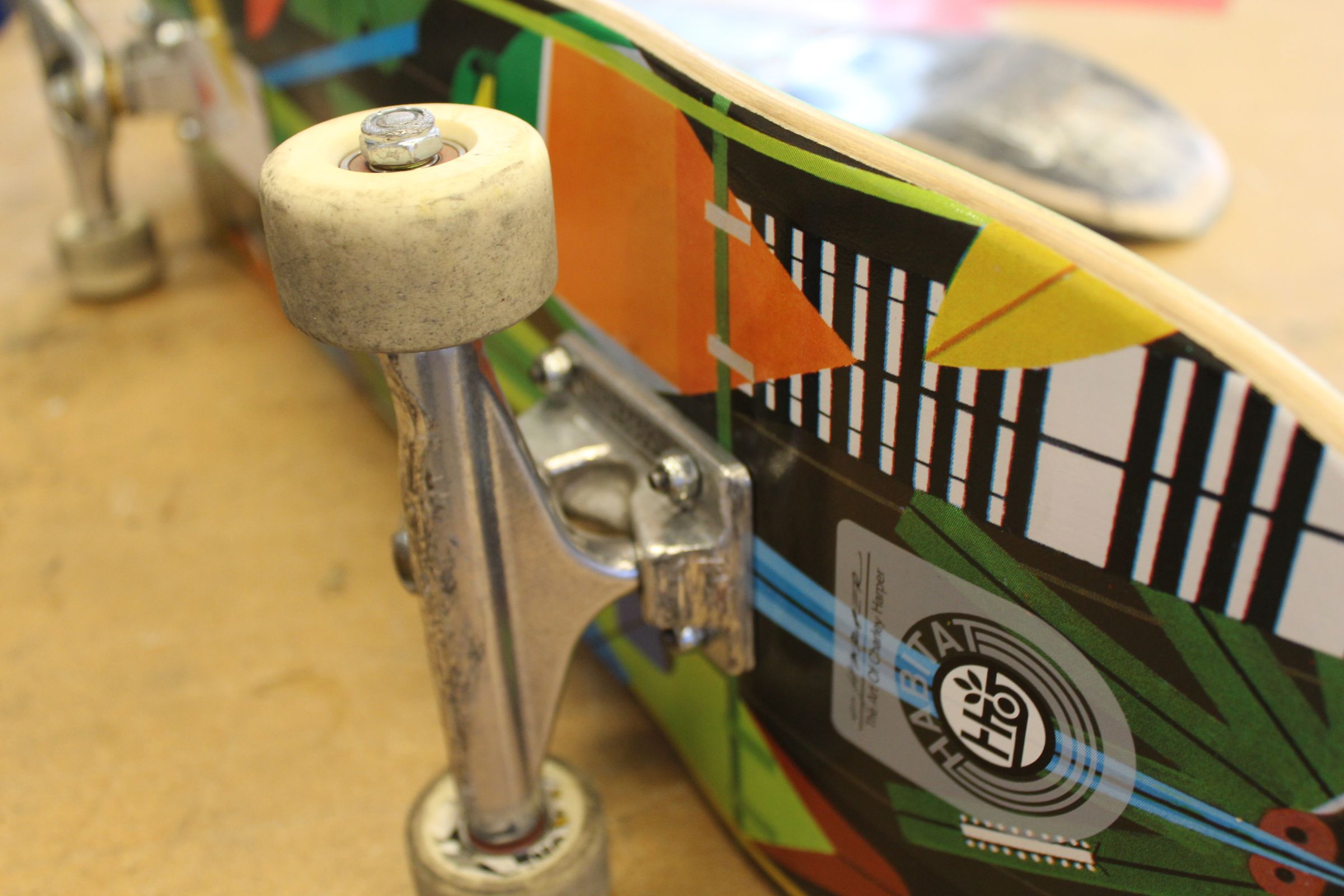

With the griptape properly applied, bend the ends of it so that it takes the form of the skateboard. Then, using the file, file the edge of the griptape following the outline of the skateboard. Make sure to hold the file at a slight angle as you apply it to the edge.
Step 4:
Using the razor blade, cut a slit at all four pockets of the skateboard in order to create a starting and ending point for your cut. Then, carefully follow the filed outline with the blade at a slight angle cutting the griptape. Carefully pull the excess griptape as you slowly cut out the outline. If filed correctly, griptape should cut easily in four sections; the two straight sides and the two round ends.
Step 5:
For the last step, use a piece of the excess griptape that was cut off and use it as a piece of sand paper. Sand down the edge of the griptape to remove any excess pieces and to give the board a clean look. Lastly, using a screwdriver poke out the 8 holes for the hardware. And that is how you grip a skateboard. I gripped mine at TechShop
