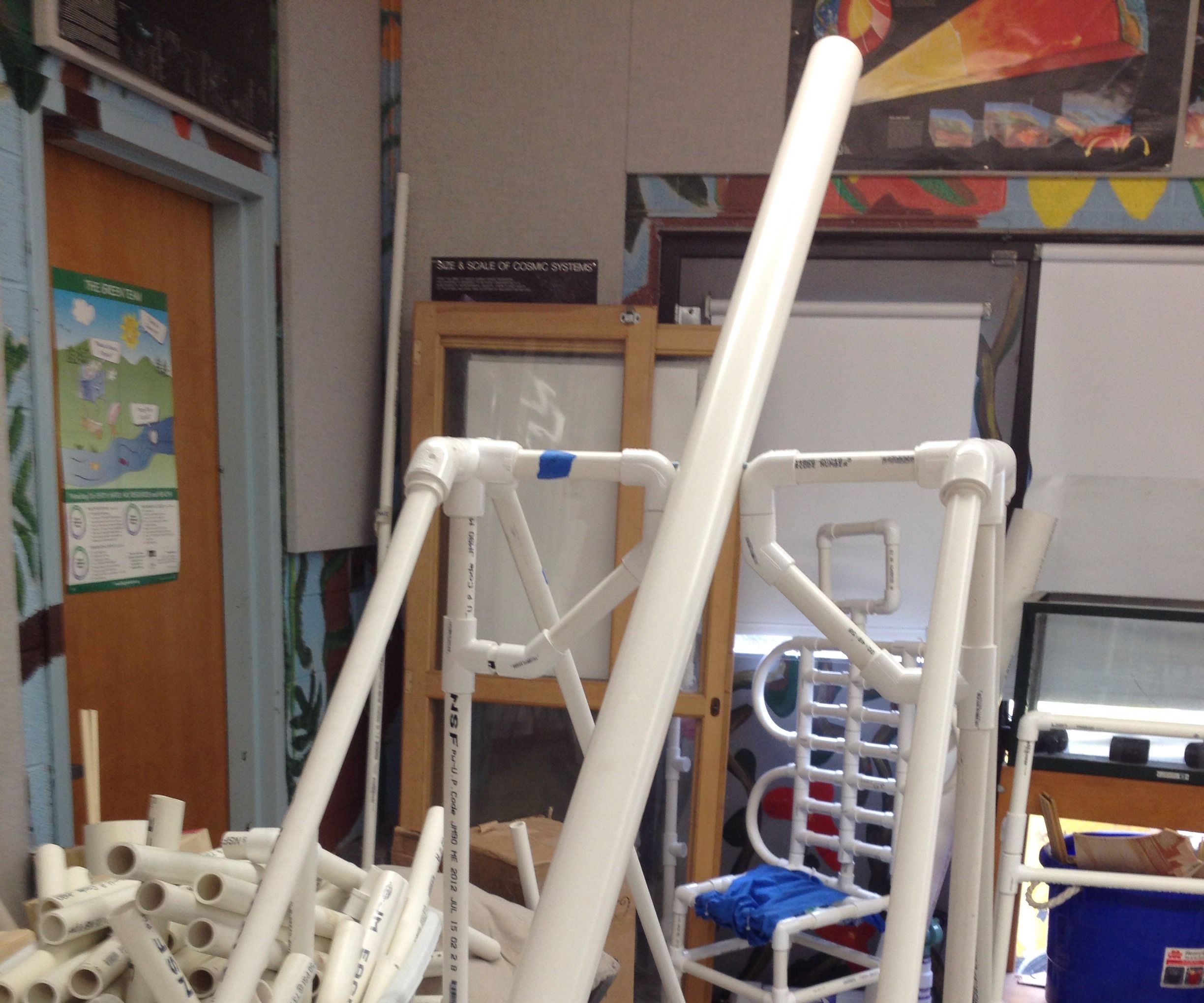

Step 1: Cut the Pipes
Cut your total 52" of PVC pipe into 2-12" lengths, 2-6" lengths, 2- 4" lengths, 4- 2" lengths.
