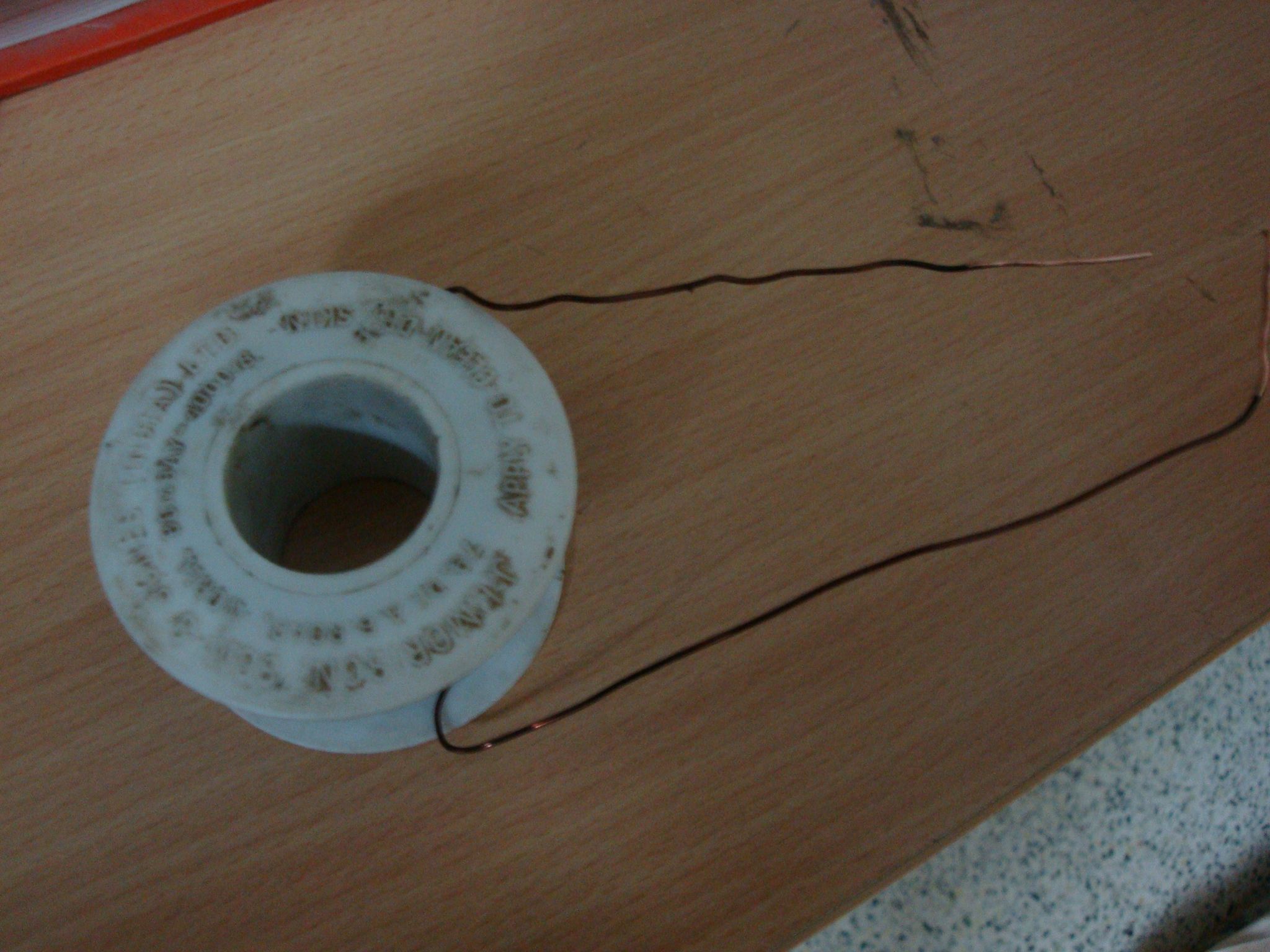

These are the items u need.
1) 9v battery
2) TSOP 1738- Important
3) 12v buzzer
4) LED
5) A couple of red and black wires.
U can solder the wires or make it on a breadboard or do it as i did.
