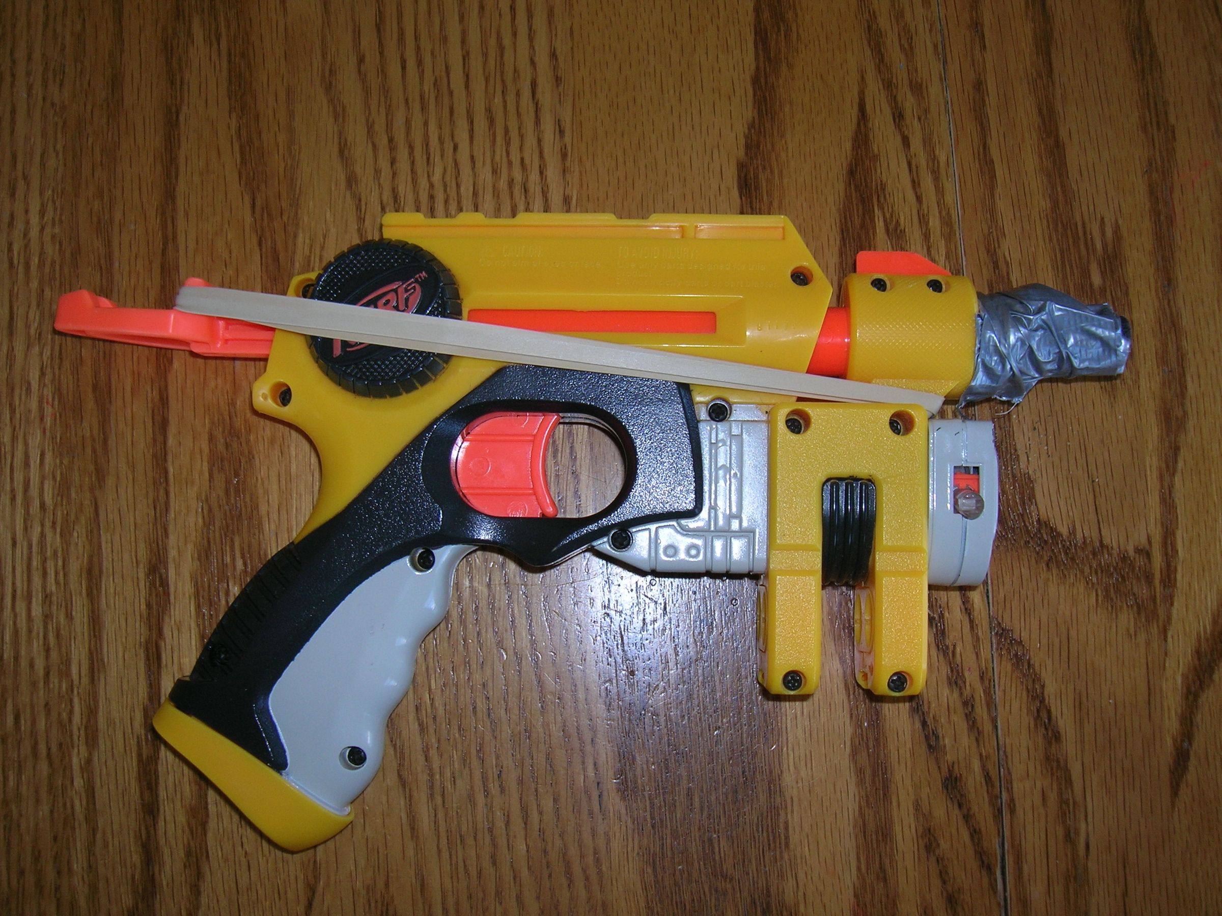

Step 2: Opening the Gun
now take your #1 phillips screw driver and remove all of the screws around the shell. keep track of where all the screws go on the gun. now lift the shell off of the bottom piece.
there are three things to keep track of. they are marked in the pictures
Step 3: Removing the Cylinder and Piston Assembly
sorry i had to use the same pic in the last step with the box things. there are two screws holding the whole firing system on. take them out and you will have the firing assembly as shown in the second picture.
Step 4: Modding the Piston and Slide Assembly
now pull cylinder off of the slide and on top of the piston is a screw. take it out and the piston will slide right off. now you can remove the spring. after you remove the spring slide the new spring on. the spring should be as long as the old spring and about the same  diameter. now slide the piston back on and put the screw back in. now take the o-ring and put it on the piston with the other one. the o-ring should have the same diameter as the old one.
Step 5: The Air Restrictor
now take apart the barrel assembly and there will be a small three prong piece and a spring on it. get rid of that. sorry the spring is not in the picture. now put the barrel back together.
Step 6: Putting It Back Together
reassemble the the firing assembly and put it back in the like it was before and screw it in. i like to leave this piece out. its the tip of the barrel. now reassemble the whole gun. batteries and all.
Step 7: Finished
 you will notice that its harder to cock the gun and louder but its worth it. thanks for reading and or modding
