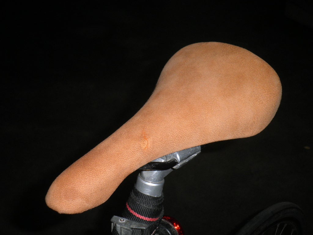

Step 9: The Final Product!
Clean up any adhesive that accidentally ended up on the seat rails, top of the seat, etc. and there you have it: a brand-spankin' new bike seat. You're only limited by your imagination (and your fabric choices)!
