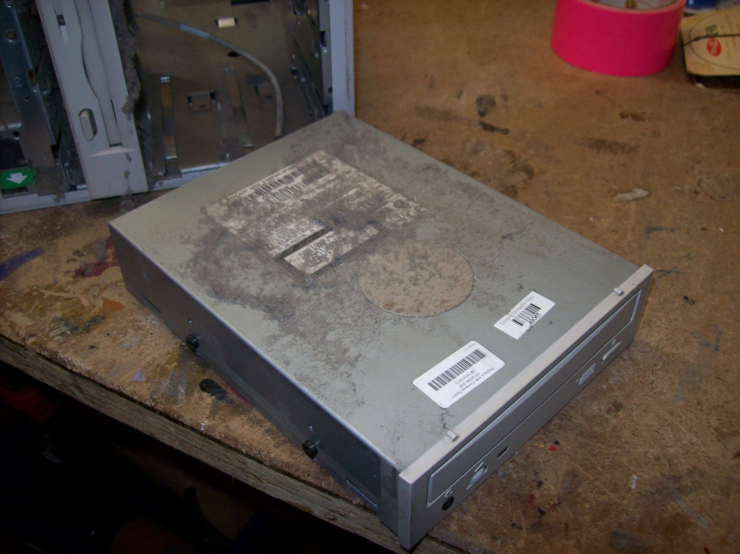

I recently got a free computer tower. It is a treasure trove, but alas, I can only grab certain things.
