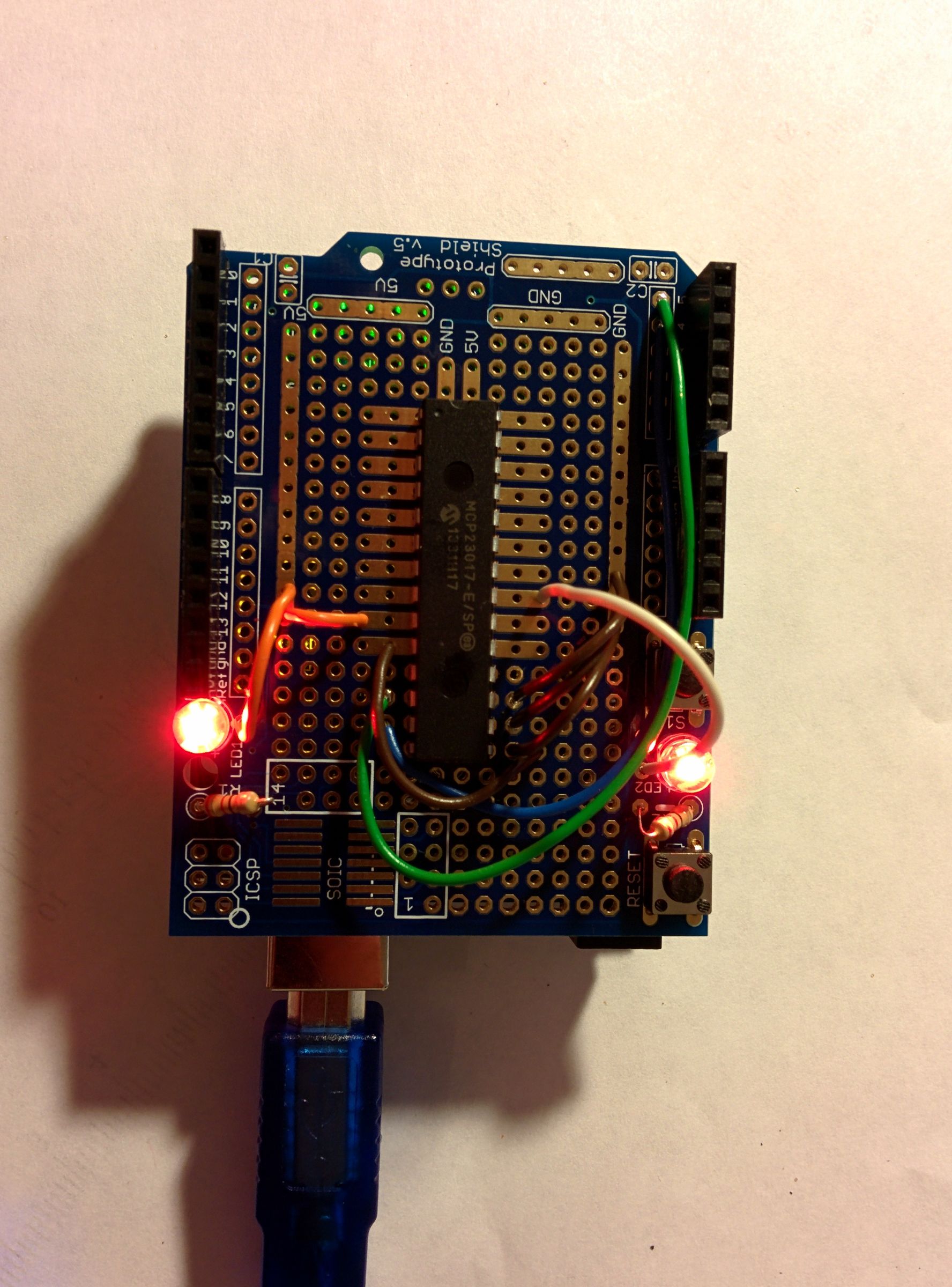

Introduction: How to Use Arduino ISP Shield 2.0
Check out my kickstarter campaign for the new model !
Turn our arduino into an ISP programmer to burn boot-loaders and upload code to Attiny85, Attiny84, Atmega328, Atmega1624, Attiny4313..
How To Burn Bootloader
In order to upload sketches via serial port you first need to burn the bootloader on atmega 328 or 168 chips.
Plugin your arduino uno to the PC.
Open Arduino IDE software.
Open File > Examples > ArduinoISP.
Select the items in the Tools> Board and Serial Port menus that correspond to the board you are using (uno or Leonardo) as the programmer (not the board being programmed).
Upload the ArduinoISP sketch. (CTRL+U).
Place ISP shield on the Arduino Uno with the chip installed.
In the Tools > Board menu, select uno if using 328 chip or deomletive if using 168 chip.
Select Tools > Programmer > Arduino as isp.
Tools> Burn booloader. Please be patient as it will take about 10 seconds. Programming light on the shield will turn on.
Done.
Now you can use serial programmers to upload sketches. Or replace your faulty chip on on anther uno board.
To Upload the sketch without burning the bootloader on atmega328 chips
Using isp shield you can also upload sketches directly to the chip without burning the bootloader.
Select the items in the Tools> Board and Serial Port menus that correspond to the board you are using as the programmer (not the board being programmed).
Open the sketch you want to upload on the chip (Eg. Blink sketch led=10).
Upload it using File > Upload using programmer. CTRL +SHIFT + U.
Done.
