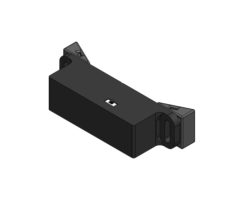

A further abstraction, packaging the BRICKS in small cylinders that plug into a D1M WIFI BLOCK hub, pumping the values to a MQTT server, is being developed.

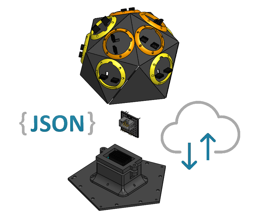

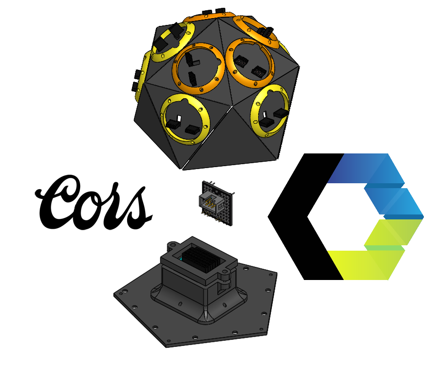

    I have slated/started a (3D printed) packaged network of sensors that use this framework and will link to it as parts are published.
    This BLOCK is used by the MQ2 ASSIMILATE SENSOR.
