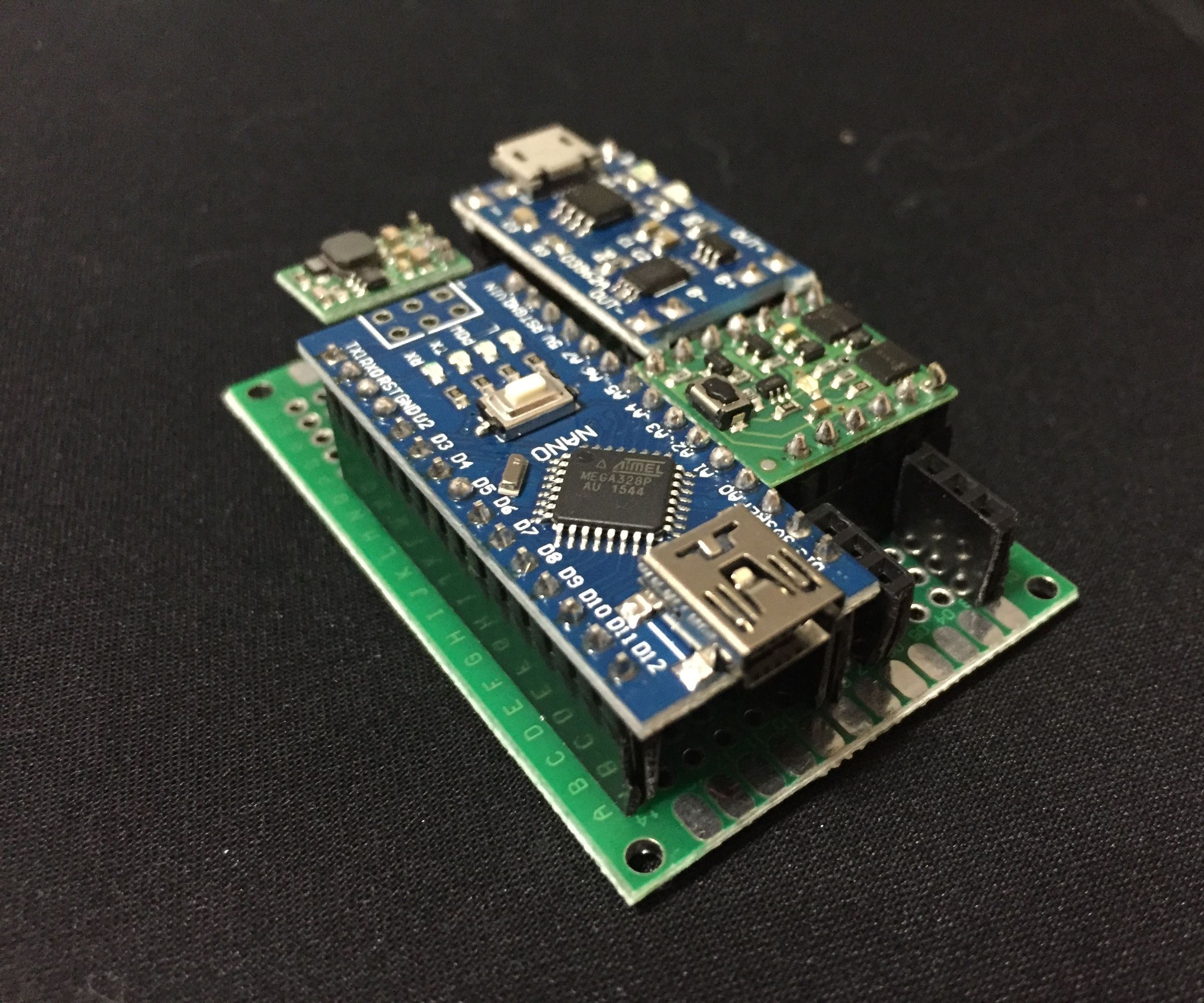

Now that the program and wiring are done, I needed to create a functional prototype. This prototype had to sit near the AC unit and hold the LED out in front of the control panel. I shined a bright light onto the surface of the panel to see through the plastic faceplate and spot where the LED receiver was located. Then I proceeded to "hack" the physical prototype using rubber bands and wooden craft strips to hold the breadboard to the Arduino Uno, and to extend the LED in front of the panel. See the attached photos. Functional prototypes don't need to be pretty, they don't need to be compact, and in the best case they make use of materials you already have close at hand. This prototype worked so well that I could have used it as-is for a long time with no issues, although I probably would've found a more permanent way to affix the LED wires to the wooden stick.

After soldering all of the wires, including soldering the resistor inline with the cathode of the LED, I hot glued all of the connections for insulation, and filled the body of the periscope with hot glue to insulate there as well.
I soldered a female power supply pigtail to the Arduino power and ground through-holes to make it easy and simple to attach the wall wart power supply to the device.
Take a look at the pics for the finished product. To take it to the next level, I'm working on a sleeker 2-piece platform and cover that will hide all of the wires and components - but for now, this is 100% functional, looks a lot better than the prototype, and works perfectly!
Results
The finished product has been working great for over a week now. My girlfriend is looking forward to version 3 with the sleek case to cover the wires, and I'm looking forward to a lower electric bill in the future!
