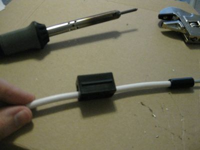

Step 1: Getting Things Together to Make a Better Cable
With a little research I found out that high-end professional gear comes from the manufacturer with an isolation transformer built in to the S/PDIF output which completely separates the sheild of the digital cable from the ground plane of the device. We should be able to simply modify our cable to include such a transformer near the output of the sound card.
What we need is a pulse transformer -- a transformer which is designed to transmit digital signals -- and one which is capable of at least 20MHz to support our 192kHz PCM S/PDIF audio signal. With a little thinking outside of the box, we realize that every computer Ethernet card has one such transformer to galvanically isolate the network interface circuitry from the transmission medium, the Ethernet cable. All we need to do is find an old 10/100 Ethernet network card and steal its pulse transformer -- I had an old AMD PCnet 10/100 card lying around which had a Pulse-brand transformer on it. Most common on Ethernet cards are Pulse or Bel-brand transformer. Any transformer suitable for FastEthernet should be suitable for our S/PDIF needs.
Just salvage this transformer from your old Ethernet card, grab a soldering iron, some solder, a knife and a side cutter, and you should have all you need to get on your way to digital audio bliss. It will also help to search the Internet to find a datasheet with a schematic of the internals of your particular pulse transformer so you know what pins to connect your cable's conductors. In my case, I found out I needed to connect the sound card side of the transformer to pins 15 and 16, and the receiver side of the transformer to pins 10 and 11. Because we're dealing with an isolation transformer, it doesn't much matter which pins we connect the shield or the core -- although if you can, you should try to match up shield-shield and core-core leads on the transformer. In my case, I attached the shield to pins 16 and 10 (the "top" leads) and the core to pins 15 and 11 (the "bottom" leads).

Step 2: Putting It All Together 1/2
Now that we have everything we need to accomplish this amazing feat of digital audio goodness, simply cut your digital cable as close to the sound card side of the cable as you are comfortable doing. Strip the cable to reveal the shield and core conductor of each side of the cable. I bent the leads of my cable so that I could more easily put the assembly in a small plastic case I had lying around when its all said and done.
