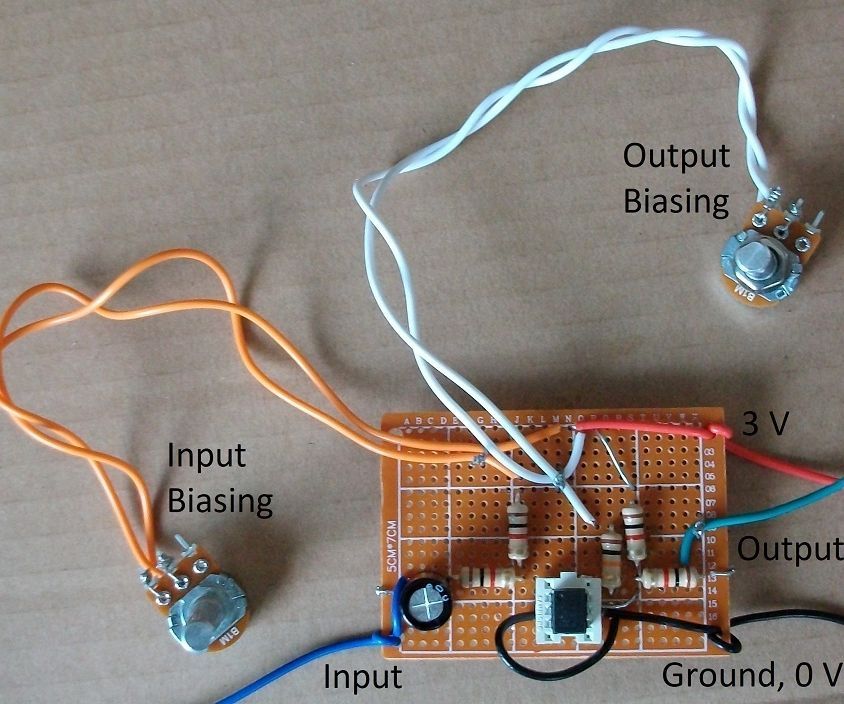

Step 3: Build the Circuit
I used high power resistors. You do not need high power resistors for this circuit. Probably Rd1 and Rd2 need be high power if you raise the supply voltage and use high current infrared diodes.

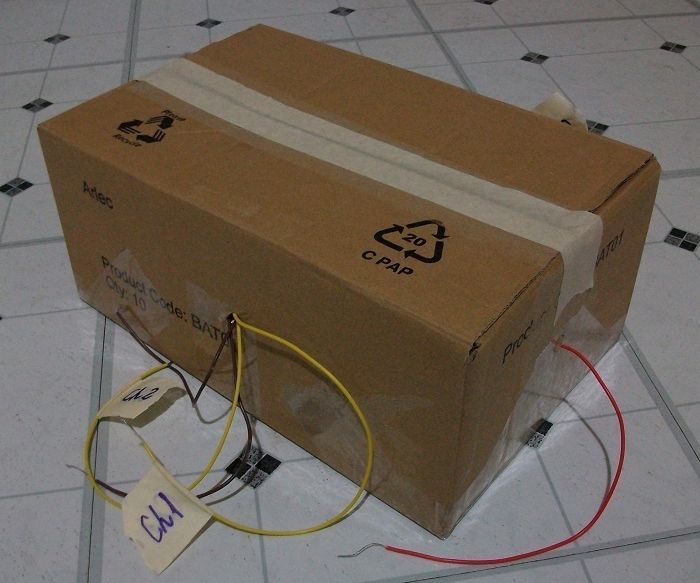

I connected the purple channel to one of the infrared transmitter nodes (the second node is connected to power supply).
My signal generator has a maximum output of 15 V peak or 30 V peak to peak. However, for the graphs above I set the signal generator to minimum settings. My USB oscilloscope is showing the wrong scale for the light blue channel. The input signal amplitude was set about 100 mV peak.
