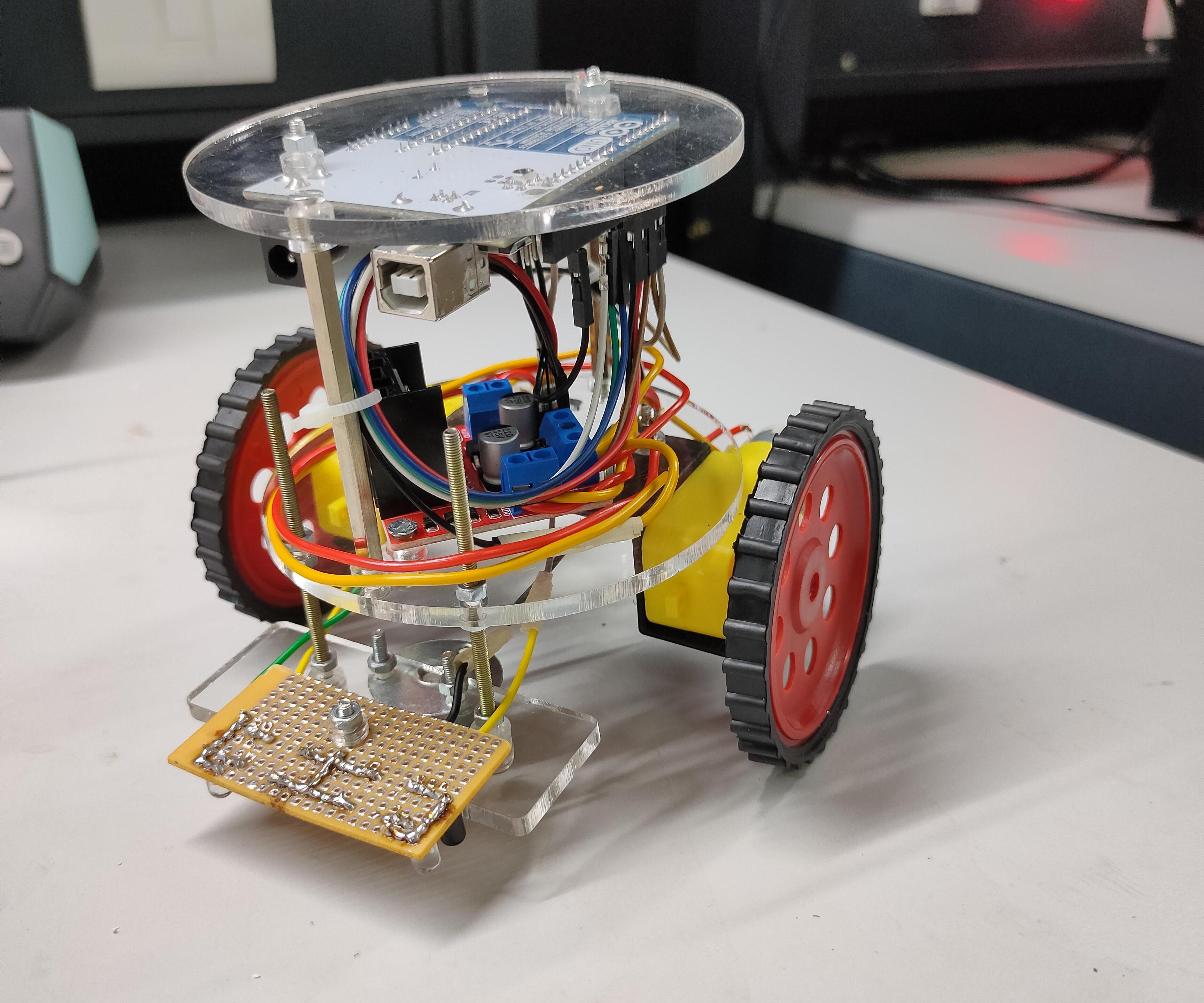

Step 28: BO Motor and Driver
Use the below code to run two BO Motors with L298N Driver. I used an external power supply of 12V and maximum current of 0.3A
#define in1 4
#define in2 5
#define enA 6
#define in3 8
#define in4 9
#define enB 10
void setup() {
  // put your setup code here, to run once:
  pinMode(in1, OUTPUT);
  pinMode(in2, OUTPUT);
  pinMode(in3, OUTPUT);
  pinMode(in4, OUTPUT);
  pinMode(enA, OUTPUT);
  pinMode(enB, OUTPUT);
  // Turn off motors - Initial state
  digitalWrite(in1, LOW);
  digitalWrite(in2, LOW);
  digitalWrite(in3, LOW);
  digitalWrite(in4, LOW);
void loop() {
  // put your main code here, to run repeatedly:
  digitalWrite(in2, HIGH);
  digitalWrite(in3, HIGH);
  analogWrite(enA, 90);
  analogWrite(enB, 90);
