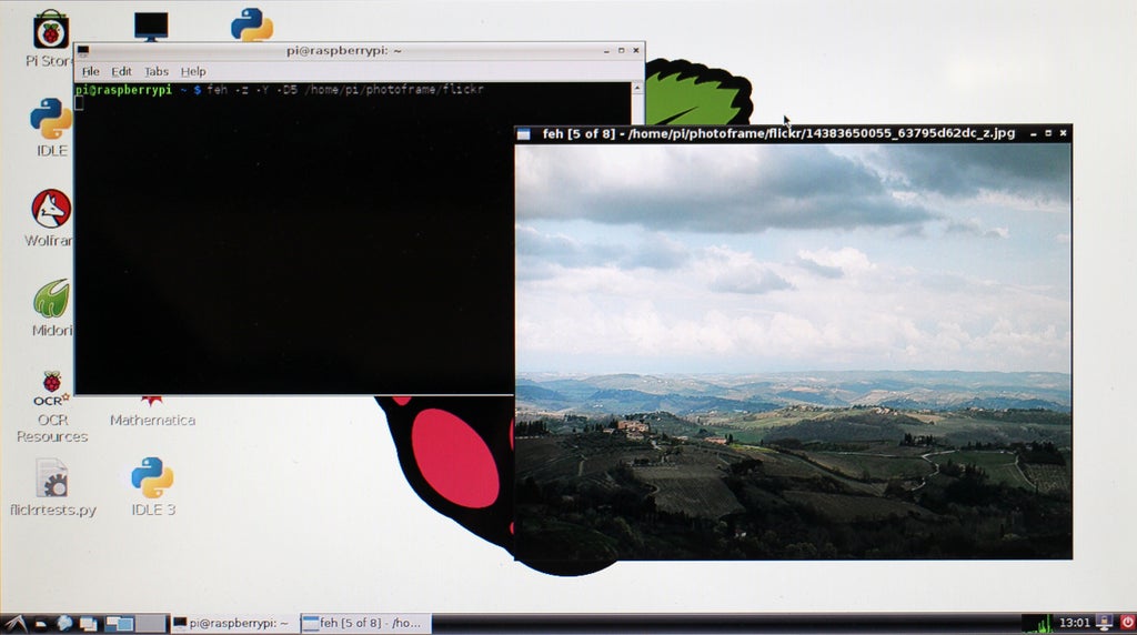

STEP 2: Install Feh
The Raspberry Pi is essentially running a full-screen slideshow and updating the folder it pulls the photos from. To run the slideshow, I used an image viewer called "feh". You can find documentation here. To actually install feh, type "sudo apt-get install feh" in the terminal window of the pi and hit ENTER. This should automatically download the library and install it in the proper location (if you are connected to the internet).
In the feh documentation, you can see the options available for the image viewer. I used the full screen, delay, full zoom, hidden cursor, and randomize options. This meant that my line of code looks like "feh -F -Z -z -Y -D5 /home/pi/photoframe/flickr" (the file path is the location where I store the photos I pull from Flickr). For testing, I used a delay of only five seconds so I can check that it works without waiting. The final frame will have a longer delay of five minutes or so. Feh is run directly from the terminal window, so you can test if it is working pretty easily.
STEP 3: Write Shell Scripts
Since feh is run in the terminal, the slideshow itself can't be directly run from within the python code. However, shell scripts (.sh files) containing terminal commands can be run from python code. I wrote two scripts - one for running the slideshow and one for closing it - and saved them both in the directory /home/pi/bin. More info on how to write a script can be found here.
Running the slideshow ("sudo nano /home/pi/bin/script_slideshow") :
#!/bin/bash
DISPLAY=:0.0 XAUTHORITY=/home/pi/.Xauthority feh -Z -F -z -Y -D 3 /home/pi/photoframe/flickr &
