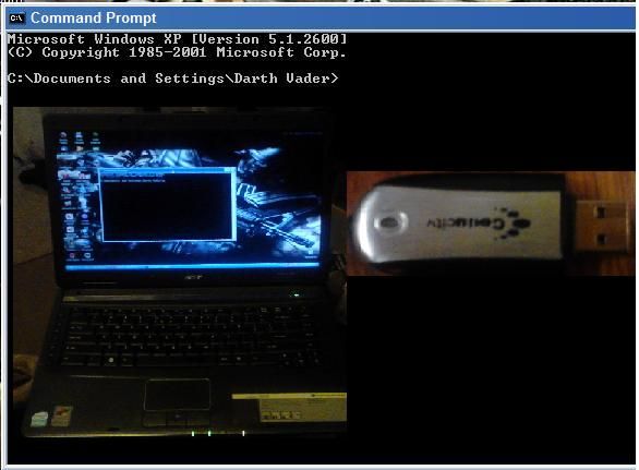

Now go to command prompt and get root access for those who don't know type in cd\
now type the path of where u installed the sdk mine is C:\Program Files\Android\android-sdk\platform-tools\adb
that is the path u should enter in command prompt.
on your phone you should enable usb debugging mine is Settings>applications>application development>usb debugging
in command prompt u should get a whole list of stuff, first of all type in adb usb
this resets the usb connection between your pc and phone.  (please note: DO NOT MOUNT THE USB CONNECTION ON YOUR PHONE)
