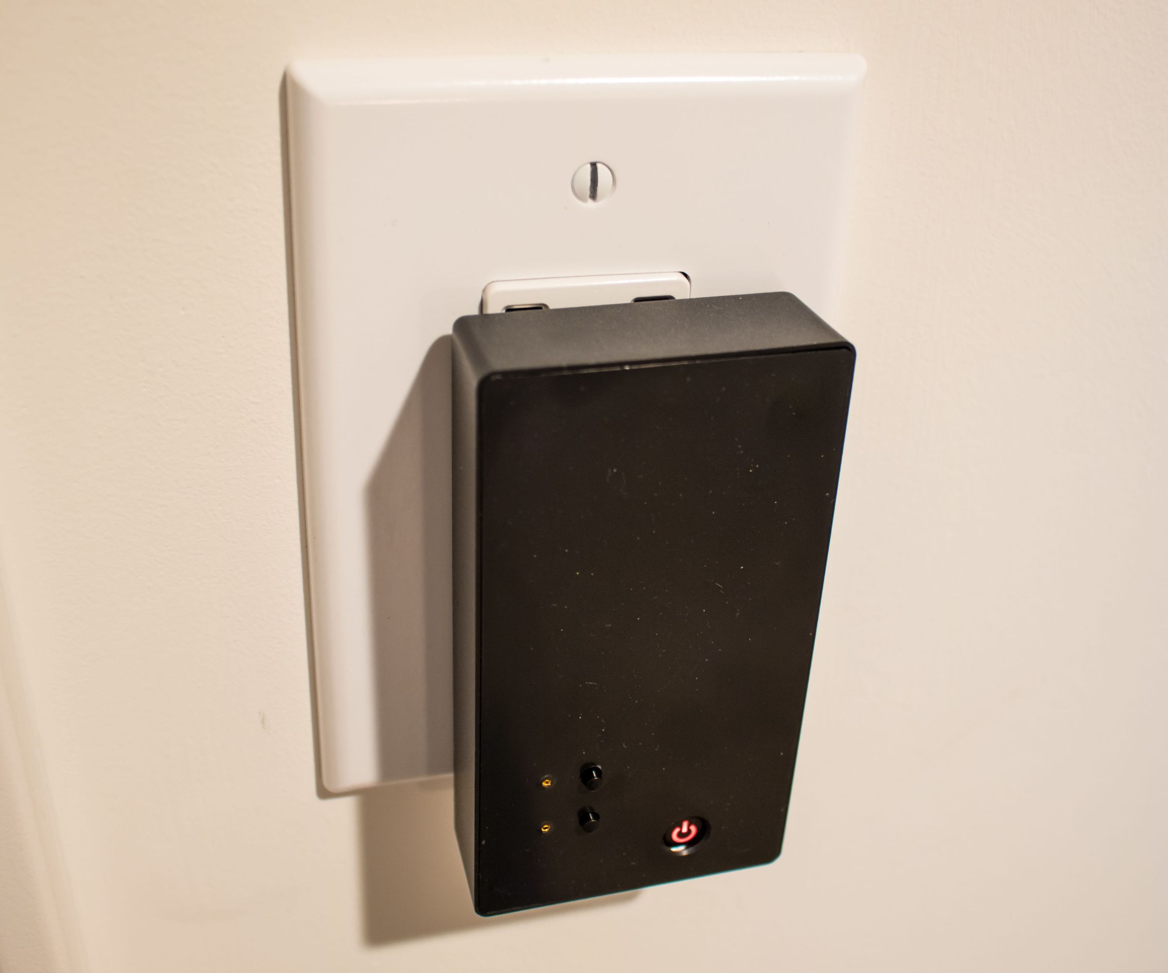

About a year ago, I felt like some rooms in my house were colder than other ones. I wanted to check for sure, so I built a few temperature and humidity sensors connected to my phone via wifi, and dispersed them in my house.
I could simply have picked up one thermometer, and moved it from room to room, but this way I can better see the temperature in real time, I can see how they evolve through the week or through the year, and I can see if the temperature in a room is completely off compared to the other ones. Plus, I can check the temperature and humidity when I'm away.
I wanted something very simple with no bells and whistles. I also wanted something small and neat looking since it will be installed permanently, this is why I designed my PCB, instead of using a breadboard.
My sensor simply plugs in a USB outlet to get the 5V power, this way there is no battery to change or recharge.
I am using and ESP8266 for the wifi connection because of its small size and cheap price.
I use the Blynk app to view the temperature and humidity on my phone, because of its simplicity of use, and because I already use this app for other IoT stuff in my house.
The total price per piece is about 23$ (not including shipping costs). Of course it can be cheaper or more expensive depending on where you source your components, and if you buy them in bulk.

Once everything is soldered, install the standoffs at the 3 locations. Cut 2 pieces of plexiglass, the size of the assembly. Drill holes in the plexiglass at the same locations as the standoffs, plus one hole that will be used to hold the DHT22 down. Cut a small piece of plexiglass the same width as the standoffs, and glue it to the top piece using CA glue. This is to prevent heat sources on the board from affecting the temperature readings. Screw the bottom and top pieces of plexiglass to the standoffs.
Then plug it in a usb socket, or usb charger.

After a year of usage, I have to say that I am quite happy with these connected sensors. I am happy with the size and the design, they are not an eyesore. The code allows them to automatically reconnect to the wifi after it comes back up, whenever there is a power outage or wifi issue. It did allow me to notice that the temperature was not uniform throughout the house, which I fixed by partially closing some HVAC vents. The humidity alert is quite useful, as it notified me that my dehumidifier stopped working after one season (I guess that comes standard with all dehumidifiers, but that's another story).
