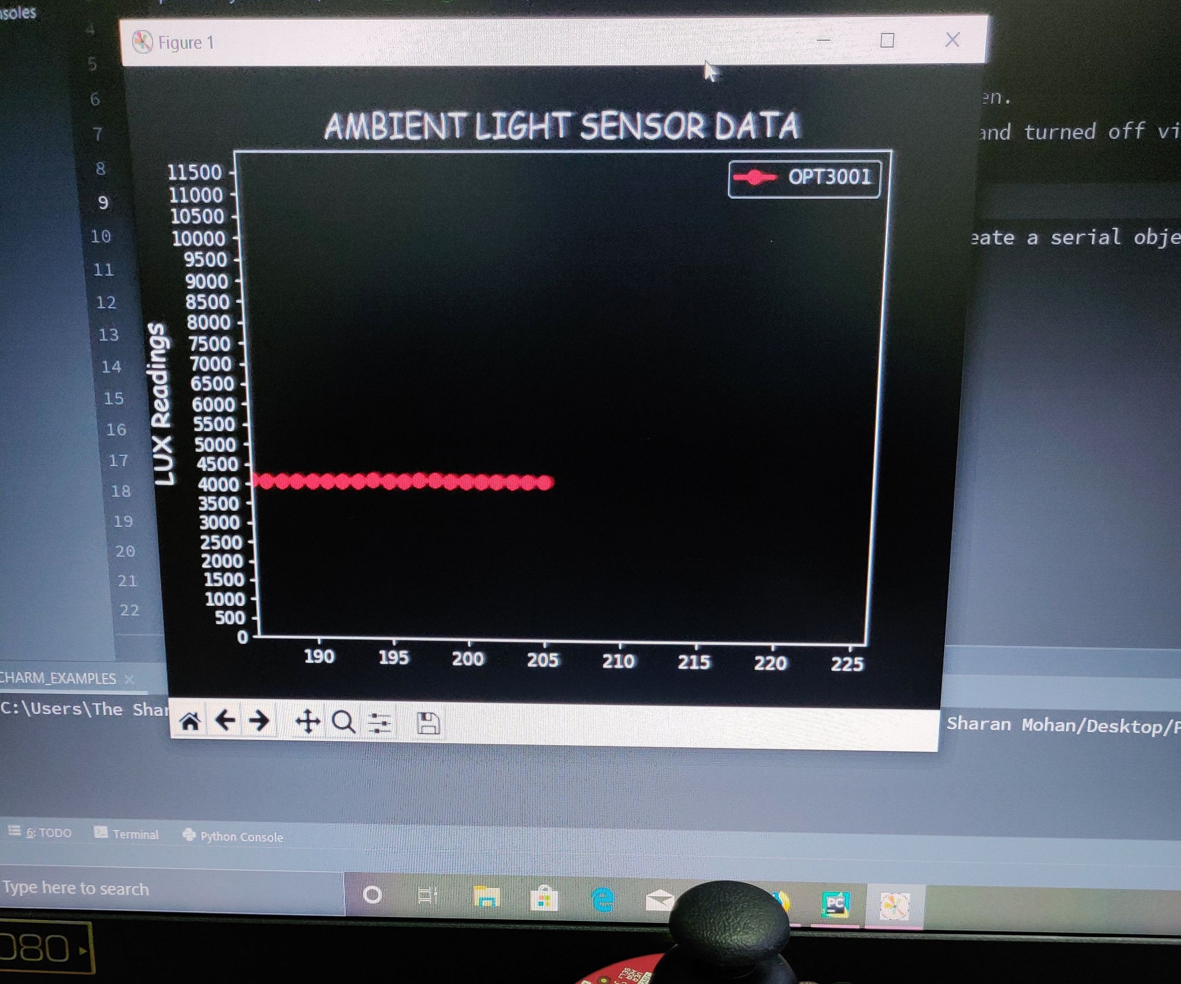

In this instructable, you’ll learn how to create an internet connected sensor! I’ll be using an ambient light sensor (TI OPT3001) for this demo, but any sensor of your choice (temperature, humidity, potentiometer, etc.) would work. The sensor values will be published to a cloud-based application using MQTT.
There are many tutorials out there that show how you can achieve this using an Arduino or a Raspberry Pi. We'll accomplish this demo using TI's (Texas Instruments) LaunchPad Ecosystem.

E2. Energia comes preloaded with example programs for the Educational BoosterPack MKII. To verify that the light sensor is working, open and upload the example code for OPT3001 by going to: File > Examples > EducationalBP_MKII > OPT3001_Demo
E3. If everything is working, the light sensor readings should start streaming into the Serial Monitor. Vary the light exposure to see the sensor values change.

N7. Click the debug tab to finally see sensor values from your LaunchPad streaming in!
N8. Click the link in the Layout tab of the dashboard to see sensor values in chart and gauge mode.
