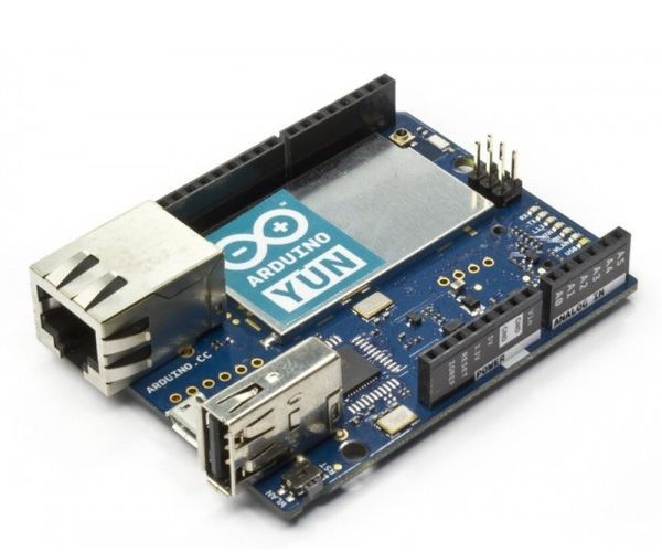

Step 2: Wiring the Board
This lessons combines the previous two lessons, so its likely that you already have most of the wiring done from the previous lesson. Wire the Arduino according to the picture at the beginning of this lesson.
Resistors
The 10k Ohm resistor is one part of the voltage divider, working in partnership with the photoresistor.
The 330 Ohm resistor connects to the negative (shorter) lead of the LED.
Wires
This is where building a habit of connecting positive (5V) and negative (GND) pins from the Arduino to the breadboard side-rails starts to pay off. In this lab the pin coming from GND to the negative side-rail supports both the photoresistor circuit and the LED circuit.
- Connect 5V to the red/positive side rail.
- Connect GND to the blue/negative side rail.
- Connect the red/positive side rail to one end of the 10k resistor.
- Connect the other end of the 10k Ohm resistor to both one end of the photoresistor and to analog pin 0 (A0).
- Connect the other end of the photoresistor to the blue/negative side rail.
- Connect digital pin 13 to the positive lead of the LED (the longer lead is the positive lead).
- Connect the other lead from the LED to the 330 Ohm resistor.
- Connect the other end of the 330 Ohm resistor to the blue/negative side rail.
