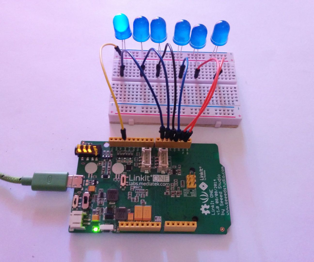

Step 2: BUILDING ELECTRONICS :- CONNECTING a POTENTIOMETER
I used a Black, Orange, and maroon jumper.The way a potentionmeter works is this:
There are 3 poles (Left, Center, Right). The center connection is a wiper that moves from one end to the other, giving it a range from very low resistance (around 1-50 ohms depending on the tolerance and quality of the pot) to around 5K or 10K ohms when measured between the center 'wiper' and the left or right connection.On one of the boards place the pins of your POT into rows 1, 3, and 5 (Left, Right, and Center)- The left pin will go to the Gnd (Black)- The Center pin will be connected to Analog 0 (A0) (maroon)- The Right pin will go to the 5v power (orange)
Step 3: BUILDING ELECTRONICS :- FIXING LED
  • Bend the cathode of all the 8 LED in such a way that the cathode is inserted in the power rail of the negative supply.Supply the ground pin from arduino to the negative railings
  • The annode leg is connected to the digital pin of the Arduino[2,3,4,5,6,7,8,9]through resistor
  • now it's time to coding.
