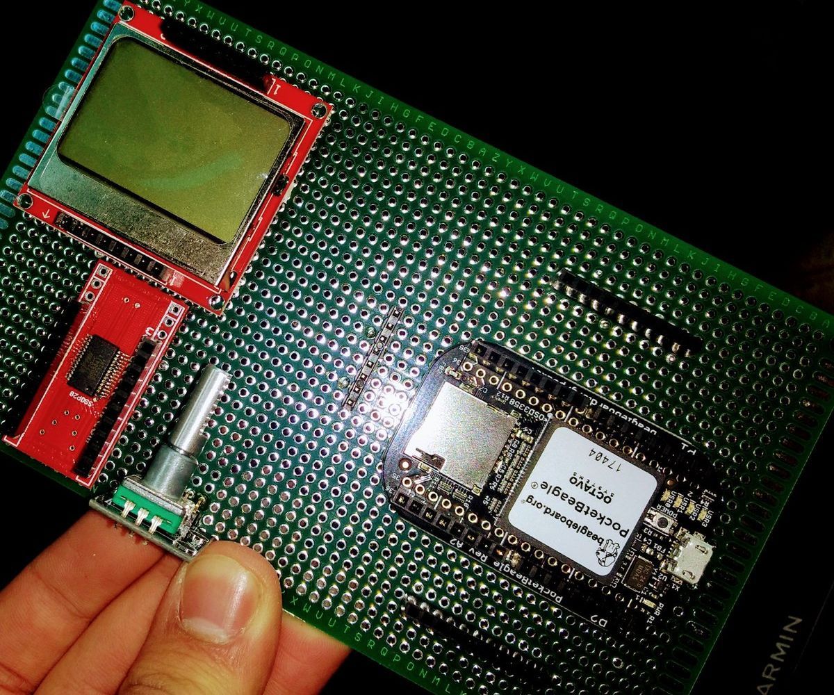

Step 3: The Circuit Design
I did a simple circuit design with wires attached to the ground, a small voltage regulator, and the diodes seen in the above pictures. I tested the voltage and everything before soldering.
Step 4: The Software Component
The software component required multiple things. One of them was a chip micro-controller then I flashed. The idea is that the generator powers the micro-controller and it automatically opens the mining software on startup. The other software component was a custom solidity contract I made for sort of a better variation of e-BTC. I also built a linux demon and stratum protocol to run the mining. Of-course you have the wireless component which is a private key generated in Everykey which can connect to 4G while mining.
Step 5: Connecting the Chip Micro-Controller
Connect the ends of the stepper motor to the ground of the circuit board, then have wires connected to the ground area of the chip computers. Solder everything together.
