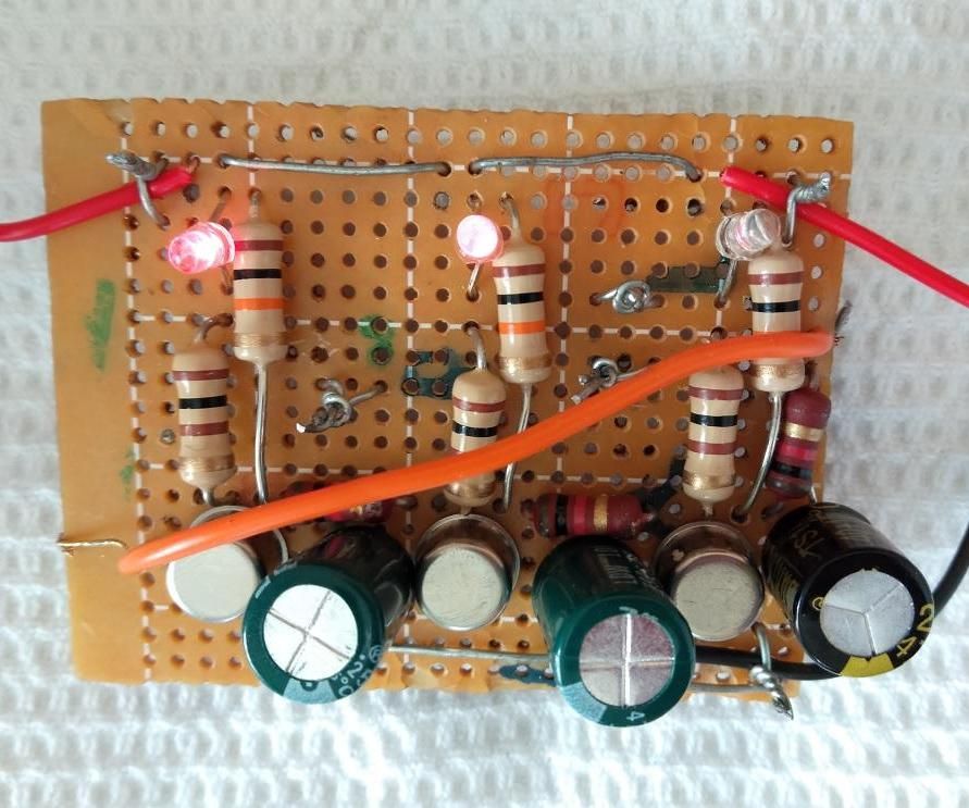

Step 3: Make the Circuit
I made the circuit by twisting the wires together. I did not use a soldering iron.
Step 4: Testing
Testing has shown that the circuit is working.
