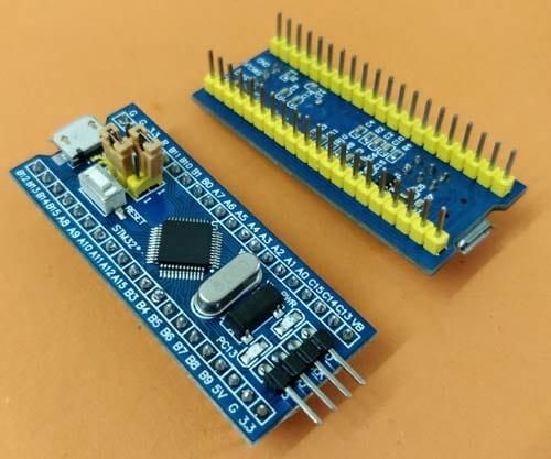

The STM32 Black Pill is a small, powerful microcontroller board based on the STM32F103C8T6 ARM Cortex-M3 processor. It has a rich set of peripherals, including GPIOs, UARTs, SPIs, I2Cs, and more, making it suitable for a wide range of applications. In this tutorial, we will learn how to display "Chitkara University" on a 16x2 LCD using the STM32 Black Pill and STM Cube IDE, without using an I2C module, but instead using HAL (Hardware Abstraction Layer) programming.

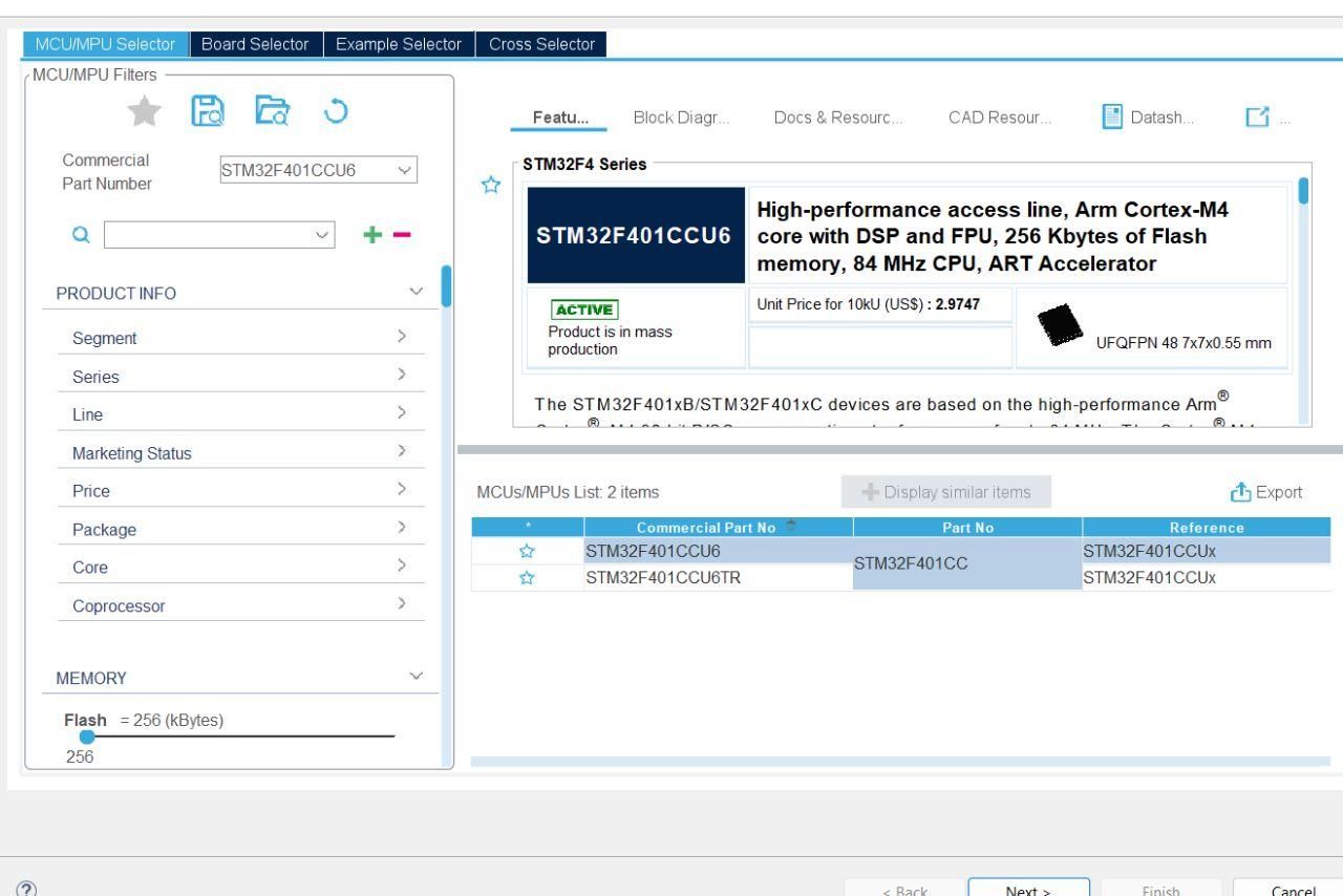

1.Open STM32 Cube IDE and create a new Project.
2.Select the board (STM32F401CCU6) and click Next.

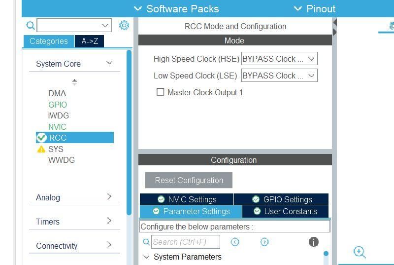

1.In System Core menu , select RCC.
2.Set the mode of High speed clock and Low speed clock to "BYPASS Clock Source".
