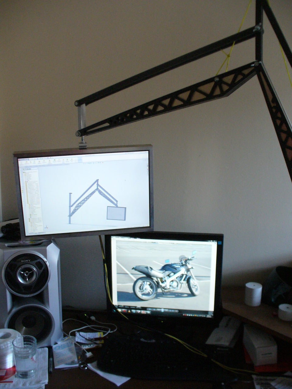

Shown here is a monster screen gantry, with a 22" screen mounted to a gantry with a 1.5m (5 foot) maximum reach.
The gantry is self balancing so you just shift the screen to position and leave it there, no mean feat with a 5kg screen!
The screen is mounted in an aluminum surround for the modern, minimalist look.

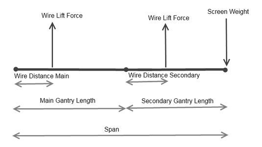

Step 2: General Dimension Calculations
For this step you must first have your screen weight and height, I shall go through the calculations using mine as an example, 5kg and 300mm.
Decide on your maximum span, in my case I wanted 1.5m.
Because the screen sits basically level with the lowest pivot point of the main gantry, the secondary gantry must be 300mm shorter to allow the screen to sit flat.
Secondary gantry length = (Span - Screen height) / 2 = (1500 - 300) / 2 = 600
Main gantry length = Span - Secondary gantry length = 1500 - 600 = 900

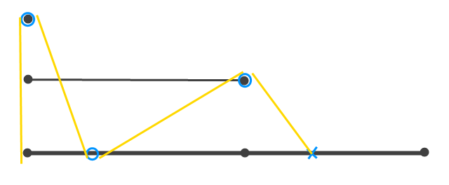

The most critical set of dimensions relate to the wire balancing setup, this ensures the screen balances when extended, rather than collapsing. I've made the generalization that the forces acting on the gantry are directly upwards, and solved it for the fully extended situation. However, when the gantry is mostly folded up these forces will be a lot different due to the wire angles; but in this situation the joint friction should overcome those effects.
Wire distance Main is how far along the main gantry the wire pulley is located. This distance governs the leverage ratio, and therefore wire tension of the gantry. I chose a 5x leverage ratio to give a 25kg wire tension, this also means for a 200mm move of the wire through the pole, gives 1m height change of the screen.
Wire distance main = Span / Leverage ratio = 1500 / 5 = 300mm
Wire distance secondary is similarly calculated, but uses the secondary gantry length instead of the span.
Wire distance secondary = Secondary gantry length / leverage ratio = 600 / 5 = 120mm
This design works best if the wire lift forces are as close to vertical as practically possible, so the height of the pole, and height of the center vertical bars should be a large as possible. Now all that is required is the mechanical design to fit these dimensions and optimizations.
The wire routing runs through three pulleys, to its fixed mount on the secondary gantry. The second picture shows the routing (yellow) and location of pulleys (blue circle) and fixed point (blue cross). The pulley system allows the gantry to extend or retract at the same height without significantly changing wire lengths or tension.

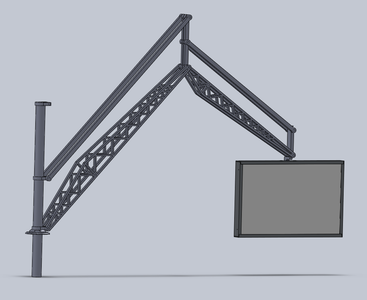

Step 3: Mechanical Design
This is where your creativity can take off, I'll give you a quick run through of my design to outline the principals and what is required from the components, but feel free to use alternate materials and designs to your advantage!
The support pole I used is 40mm 4mm wall aluminum tube, with three main pivots bolted where required. The pole also has a height setting ring, and Shelf plate, which allow it to spin on my desk.
The screen is kept level by the parallel bar linkage and can spin due to a bolt going vertically through the final vertical plate. The screen can tilt due to a high friction mount on the top of the screen.
The gantry plates and link bars are all made with two sides, and set a distance apart to ensure the gantry will not twist or fold. Various spacers were machined to ensure the plates were far enough apart.
The parts list:
Support pole
Shelf plate
height setting ring
3x main pivot plates
2x main gantry plate
2x secondary gantry plate
2x long link bars
2x short link bars
2x center vertical bars
1x end vertical plate
1x end spin hook
Not shown in the drawing are the pulleys, spacers, and bolts.

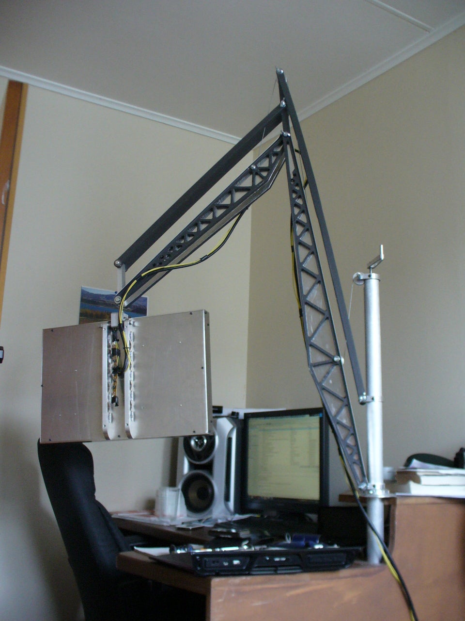

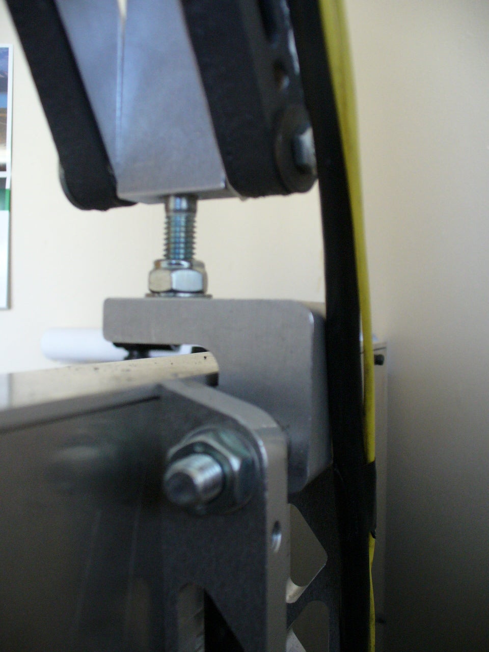

Step 6: Screen Mount
The screen mount consists of two components (three if you count the screen); the end vertical plate, and the end spin hook.
The end vertical plate mounts to the short link bars and secondary gantry plates which keeps it vertical at all times, the bolts hold aluminum bosses firmly against the flat bar to make axles, which allow the gantry plates and link bar ends to rotate freely.
An 8mm hole was drilled down the center of the end vertical plate to mount the end spin hook. The spin hook consists of an L shaped bracket, and a 150mm long 8mm bolt; a lock nut and internal thread holds the bolt to the L bracket. The bolt is free to spin so the screen can be faced in any direction. On the end of the spin hook is an 8mm hole through which the screen is mounted, spacers were added so tightening this bolt increases the friction of the join, allowing the screen to be tilted.

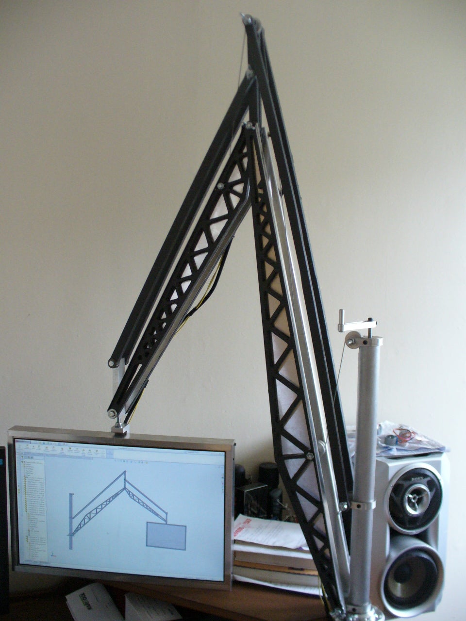

Step 8: Main Assembly
The majority of fasters used on the gantry and link bars are tightened with wingnuts, this is to allow adjustable levels of joint friction. In all instances just do them up moderately tight to start with and adjust as necessary later.
Bolt the main gantry plates to the lower support pole main pivot.
Bolt the long link bars to the mid support pole main mount.
Bolt the center vertical bars to the other end of the long link bars; remember the spacers and wire guide pulley.
Bolt both pairs of gantry plates to the lower end of the center vertical plates, again, remember the spacers.
Bolt the short link bars to the middle of the center vertical plates.
Bolt the short link bars, and secondary gantry plates to the end vertical plate.
You now have the main moveable assembly sorted, test it out by moving the screen around, and ensure it can move in the directions it should (postition, spin, tilt) while staying horizontal. Next is the pulley/wire system...
Start by bolting the fixed end to the secondary gantry plates.
Next bolt pulleys onto the main gantry plates, and top main pivot plate on the support pole.
Route the wire over the center vertical bar pulley, under the main gantry plate pulley, over the support pole pulley, and down through the support pole.
Step 9: Pre-testing
It is now time to test the wire balancing system!
This may require two people, or a higher shelf to rest your screen on. In either case raise the screen, draw sire through the bottom of the support pole and tie it off (I knotted it around a bolt). This temporarily secures the other end of the wire.
The screen should now be able to be moved and positioned anywhere in a single height plane. Take care when first positioning it as it may drop significantly while the cable takes up slack.
Test many different positions, and check the gantry for any flex. My initial design using only the 12mm gantry plates allowed too much flex. The addition of 1.6mm aluminium plate on the inside of all gantry plates fixed this.

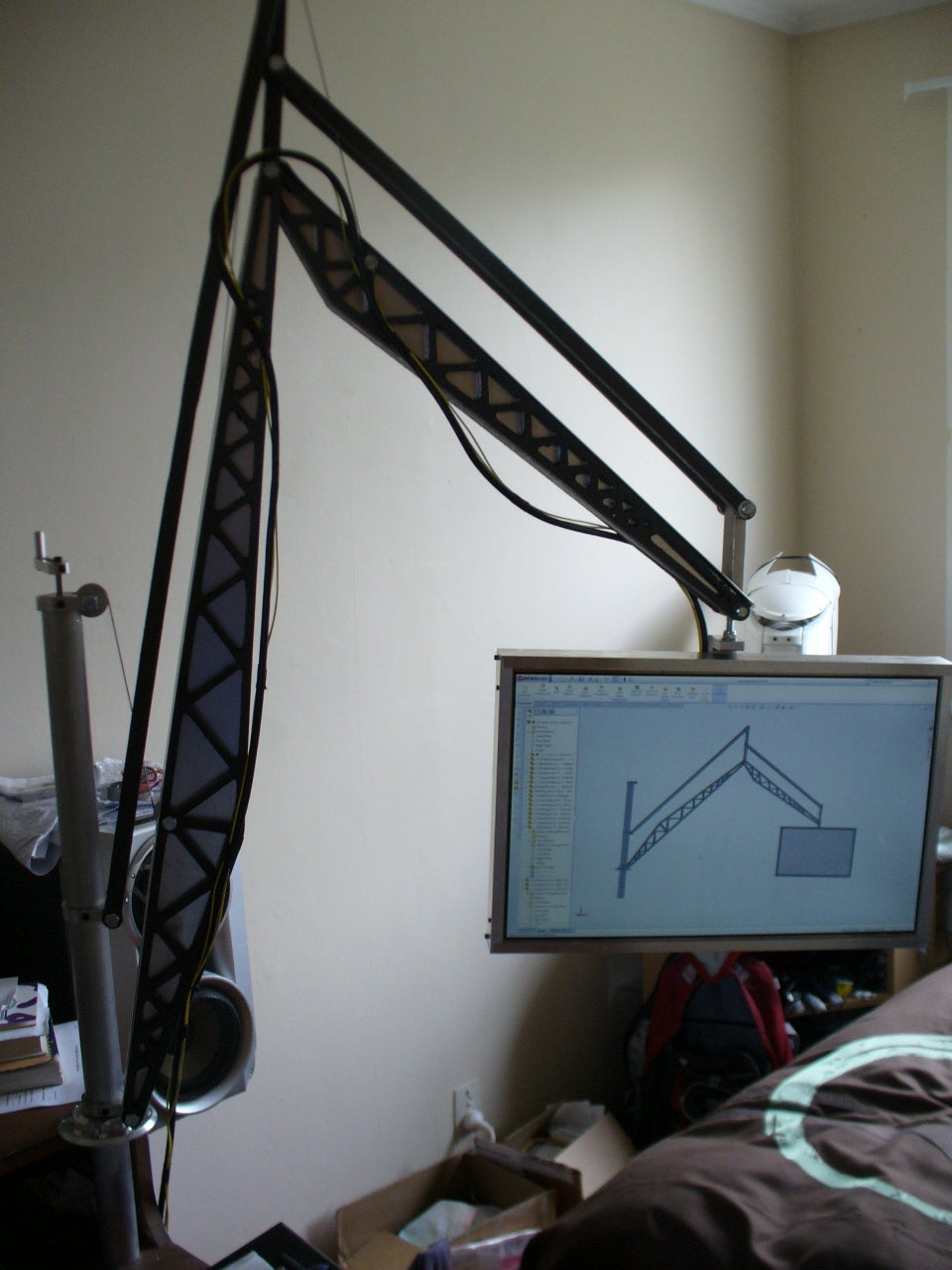

Step 11: Job Done!
As seen in the pictures, it can sit on the desk shelf as normal, or be raised, extended, to wherever the user desires!
