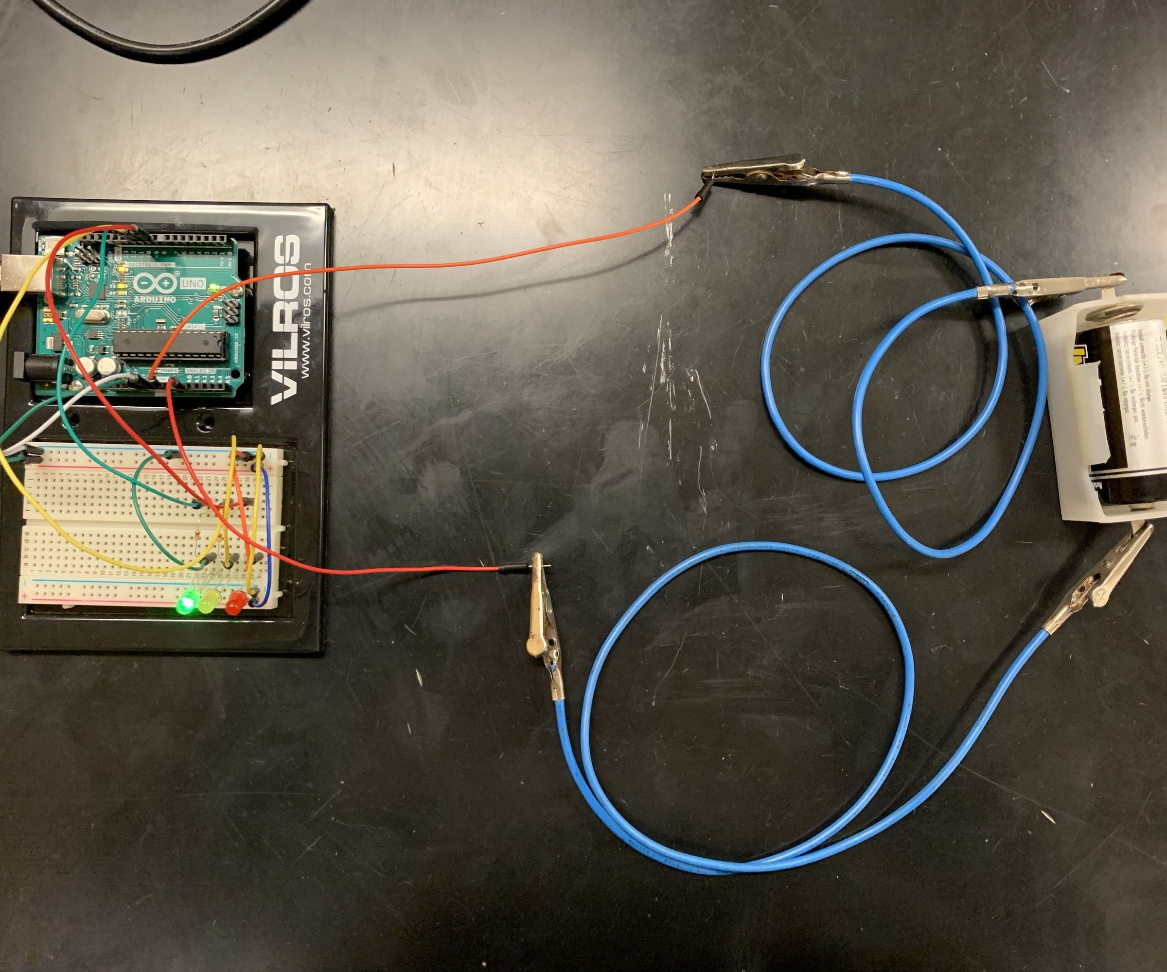

Introduction: LCD Temperature Sensor
This simple circuit uses the arduino uno to get a temperature reading and then print that reading to the LCD screen. It also has a "desired temp" that you can change and then depending on if the acual temperature is warmer or colder it will activate one of two lights accordingly.
- Arduino uno circuit board
- bread board
- 25 jumper wires (sizes vary)
- 1 LCD screen
- 2 potentiometers
- 1 temperature sensor
- 3 10K resisters
- 2 LED lights (2 different colors)
Step 1: Build Your Circuit
Step 2: Code Your Arduino Circuit
