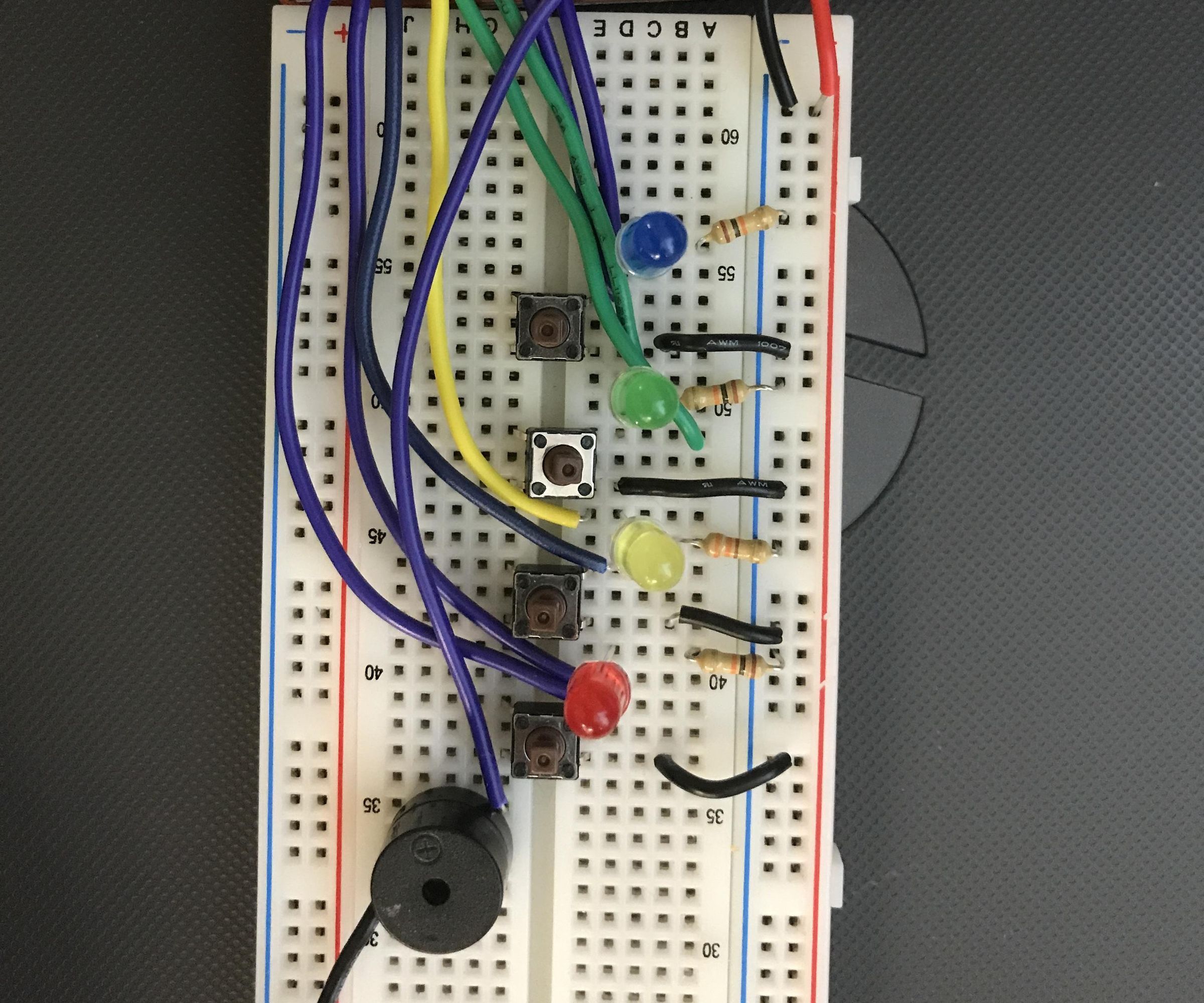

Here is a link to the tinkercad basic circuit outline (without the LCD however)
Step 1: Astable Mode With 555 Timer:
Wire the 555 timer in astable mode:
  • Connect pins 2 and 6 to each other and to the ground.
  • Connect pins 4 and 8 to Vcc (5V).
  • Connect a resistor from pin 7 to Vcc.
  • Connect a capacitor from pin 6 to the ground.
  • Connect a potentiometer from pin 6 to Vcc for adjustable speed.
The 555 timer is configured in astable mode, generating a continuous square wave output. The potentiometer adjusts the rate of flashing by changing the delay.
Step 2: Johnson Decade Counter:
The CD4017 is a decade counter that advances one output at a time in response to clock pulses. It's used to sequence the LEDs in the chaser pattern.
Connect the Johnson Decade Counter (CD4017):
  • Wire the 10 outputs to the series of LEDs (Red, Red, Red, Green, Red, Red, Red).
  • In order from left to right the LEDS in the sequence shown above are connected to these corresponding pins on the decade counter in this order, Output 1, 2, 3, 4, 5, 6, 7.
Step 3: Knight Rider Circuit:
Connect the 555 Timer with the Johnson Decade Counter:
  • Use the output of the 555 timer to clock the CD4017, creating a Knight Rider circuit effect.
  • (Note: Knight Rider circuit was the one I made on my PCB which this is heavily inspired by)
Step 4: Button and LCD Display:
Place a button on the breadboard:
  • Connect it to pin 4 on the Arduino.
  • Connect the green LED to pin 7.
  • Connect the LCD to A4 and A5. If no LCD is available, the text can be displayed on the serial monitor and be replaced in the code everywhere where it says lcd.print with serial.print.
