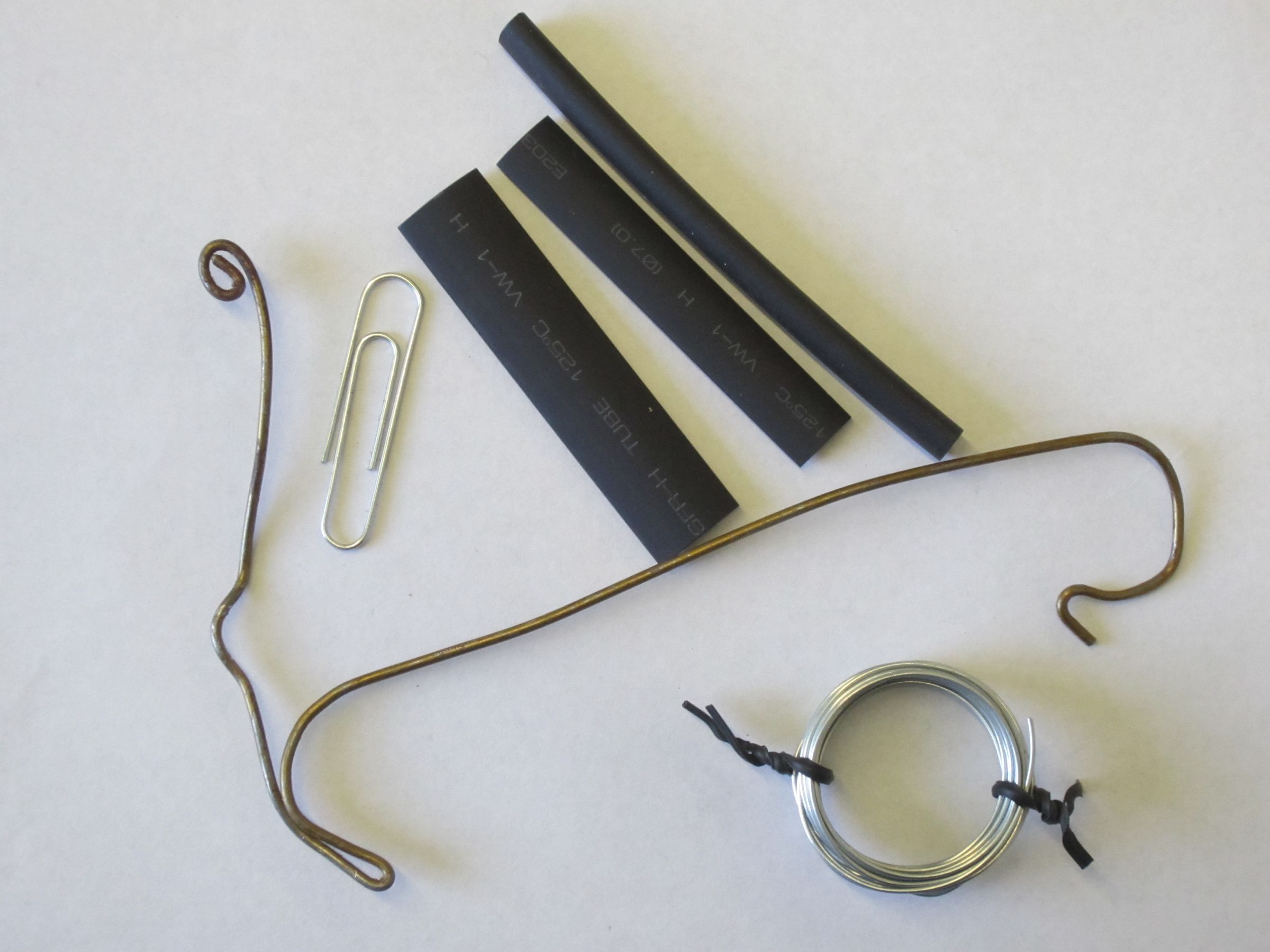

Step 3: Metal Stuff
Next prepare your stem. Any wire you can bend, that will hold its shape will work. If you pick something too soft it may break after frequent posing. I just cut a piece of coat hanger for mine.
Bend the wire to form a base for the flower, so that it will stand on its own. The circle base in the picture worked well for mine, and it would also slide nicely into a very small pot, if you went that route.
While you are cutting and bending cut a few bits of metal for your switch. I used a binder clip.

Slide your electrical wires into your heat shrink tubing. You want one long piece that will cover at least the top half of the stem, and one short piece to cover one of the electrical wires where it is soldered to the switch at the end (so it does not short out.)
Slide the wire for the pose-able stem in from the other side.
For the switch: solder your two pieces of metal (binder clips) to the wire ends. Be sure to slide the heat shrink tubing out of the way, so you do not shrink it early by accident.
Slide the tubing into place. The long piece will hold the electrical wires, and stem wire together neatly. The small piece will slide over the end of one of the electrical wires, so it does not touch the other electrical wire. I put a bit of electrical tape around the stem wire at the same place, also to prevent shorting.
Shrink your tubing. Use a heat source (responsibly, don't be a shmuck) to shrink the tubing, and hold everything in place. A heat gun will work, but Usually I use a lighter or candle (carefully.)
