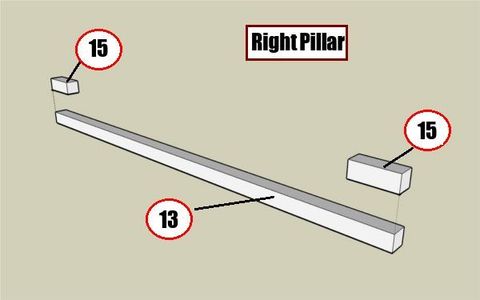

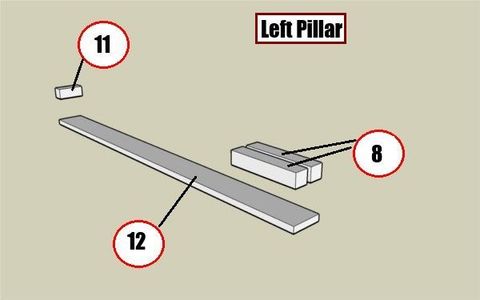

Once you have all your materials and tools you will need to measure and cut out the wooden pieces needed to build your box's frame (See Pictures).
Step 2: Build Your Frame...
Once you have all your materials and grow box pieces cut to length, go ahead and build the wooden frame of your grow box.
You can use the video in this step as an overview, as well as use the labeled pictures to guide you through the steps of building your grow box frame.

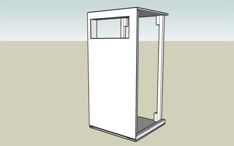

Step 3: Construct Your Intake Vent // Light Trap
On one side of the grow box you will install a air intake vent. This intake vent also serves to trap any ambient light so that the inside of the grow box stays completely dark with the light is off. However, fresh air can sill flow through the grow box unimpeded, so long as the exhaust fan is running.
After you have constructed your intake vent/light trap, make sure the vent makes a comfortable fit into the frame of the grow box.
Step 4: Enclose Intake Vent Within the Grow Box Frame With Custom Panels.
Next, enclose your finished intake vent with the grow box frame using two custom fitting panels. One panel is covers the vent's outside, while the other covers the inside.

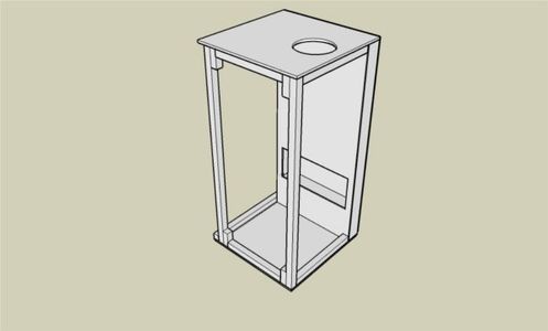

Step 5: Cut Hole (on Box Top) for Your Carbon Filter/Exhaust
On the top of your box, you will cut a 8 diameter circular hole. This is the area where your carbon filter's 8" inch tent flange will fit.

Step 7: Attach Eyebolts, Side Panels & Wheels
Its best to install the eye-bolts before fitting the panels. The eye-bolts give you an anchor to affix lights or fans.
Attach the remaining side panels to your grow box. Once finished, the remaining space left open will effectively act as your front door/opening.
