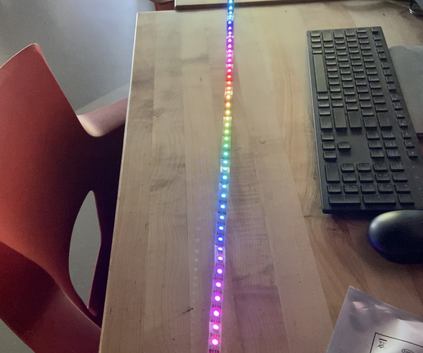

Step 5: Connect the USB to the LED
  • NOTICE: For this next step make sure that there is no contact between the two wires or the solder. If the + and the - side are connected at all when plugged in, the light will not work! This will not break it, but will stop it from working.
  • Using the soldering iron, attach the + wire to the + pad on the LED strip
    • This is your orange or red wire
  • Using the soldering iron, attach the - wire to the - pad on the LED strip
    • This is your white or black wire
  • Plug in the USB to ensure LEDs light up.
