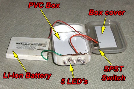

List of Parts.
1.- One PVC flat Box of size 2 x 3 x 1/2 Inches.
2.- One Single pole single throw switch.
3.- Five Very bright White LED's of 5mm size.
4.- One Discarded 3.6v Li-Ion Battery. (Lithium Battery)

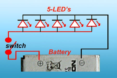

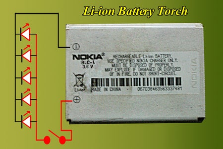

In this step follow the Circuit diagram and assemble the parts.
The 5 LED's are fixed to the PVC Box.
The Switch is fixed to the Cover of the Box.
All the 5 LED's are connected in parellel with a switch to the Battery.
LED's are connected PARALLEL because the output voltage of the
battery is 3.6 volts and the White LED runs on 3.3vots.
The longer leg of the LED is the positive pole and the shorter leg is the Negitive pole.
The positive pole should be connected through the SPST Switch, to the (+) side of the Battery.
The Negitive pole can be directly connected to the (-) side of the Battery.
Put some foam pieces around the Battery to keep it steady inside the box from any movement.
Put on the COVER and all is done....

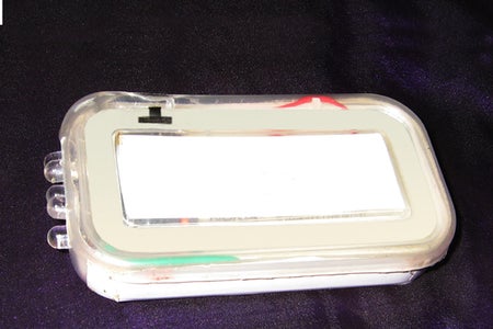

There is nothing special in this step but to see the Photograph and follow the the circuit.

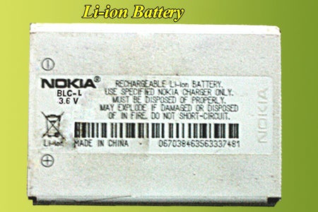

Step 4: STEP-4
View of the Lithium-Ion Battery
