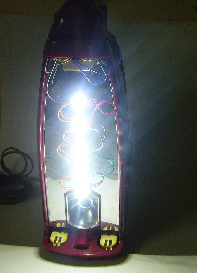

Here is simple circuit diagram and , ray diagram of torch just to help assembling parts.
Step 3: Step 3 - Assembling
Before start assembling first you remove bulb , slide switch from the torch.
Make 6/5 mm hole for charging socket and 3 mm hole for red LED as shown in picture. cut the square hole for switch as required.
Make wiring as per circuit diagram, just see the photograph.
After completion of wiring do the continuity test & charging voltage , if all test are done then switch on torch , here you go live.

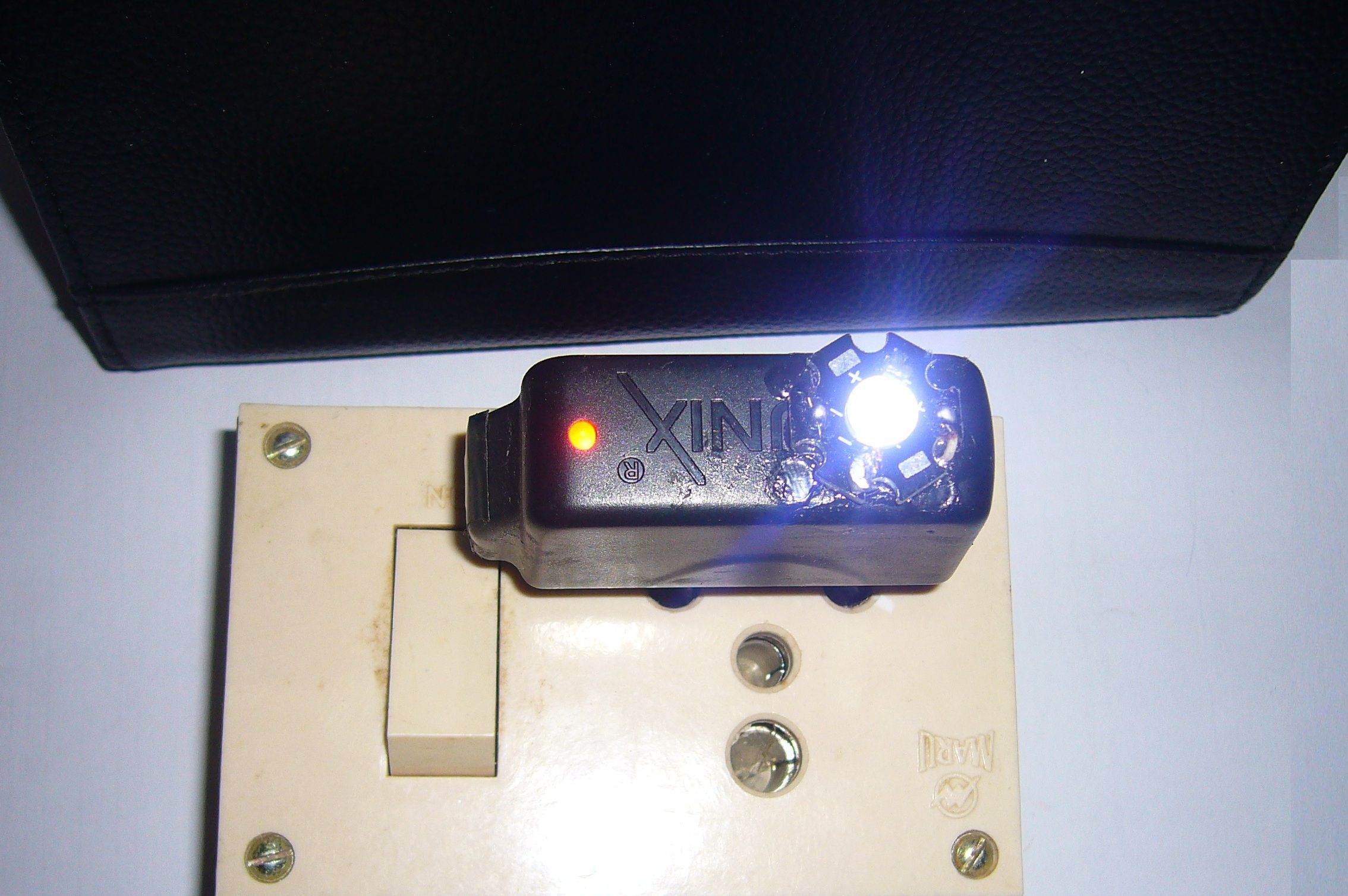

Step 4: Step 4 - Finishing
Finished torch, see charging indicator. Here we go live.
