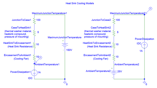

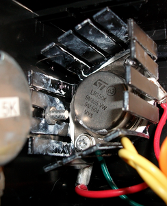

The component heat dissipation model will help you choose the heat sink. More information is in this link:
https://www.instructables.com/Component-Heat-Dissipation/

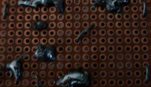

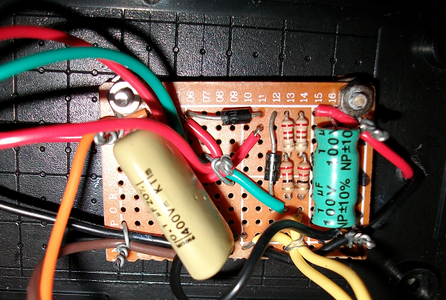

Step 2: Build the Circuit
I made my power supply with used components.
Both capacitors are electrolytic capacitors.

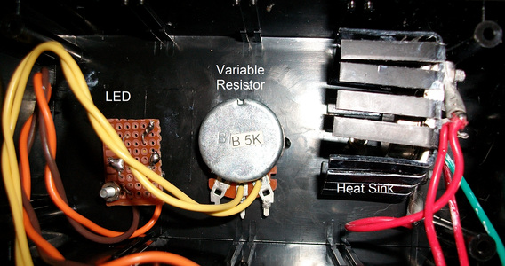

Step 3: Encasement
The photos show the encasement.
I used a black plastic box. The optional LED circuit also has a 1 kohm resistor connected in series with the LED to limit that maximum LED current. Typical LED current should not exceed about 15 mA. Typical LED voltage is 2 V.

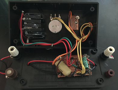

Step 4: Wiring
I did not use professional wiring. Those type of power supply must be constructed with a larger encasement.

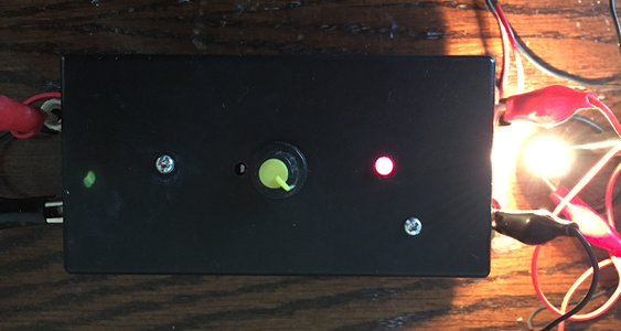

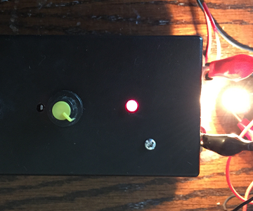

Step 5: Testing
Testing show the power supply working.
