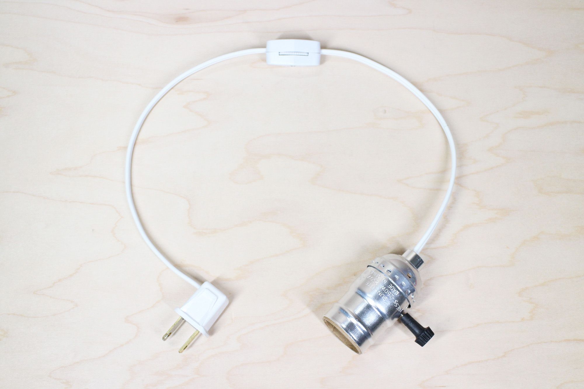

To learn proper wiring techniques, in the next few lessons we'll be making two mini practice lamp cord sets.
Practice cord set #1
Practice cord set #2
Before ordering the items you need (listed below), I recommend having a look at the lamp projects I link to in Lessons 7 & 8, because if you choose to make one of them, you may be able to use some of the parts you'll need for those in this lesson.
NOTE: You'll be able to re-use everything from the practice cord sets for your lamps – with the exception of the short lengths of lamp cord – which will save you $$ on future lamp projects.

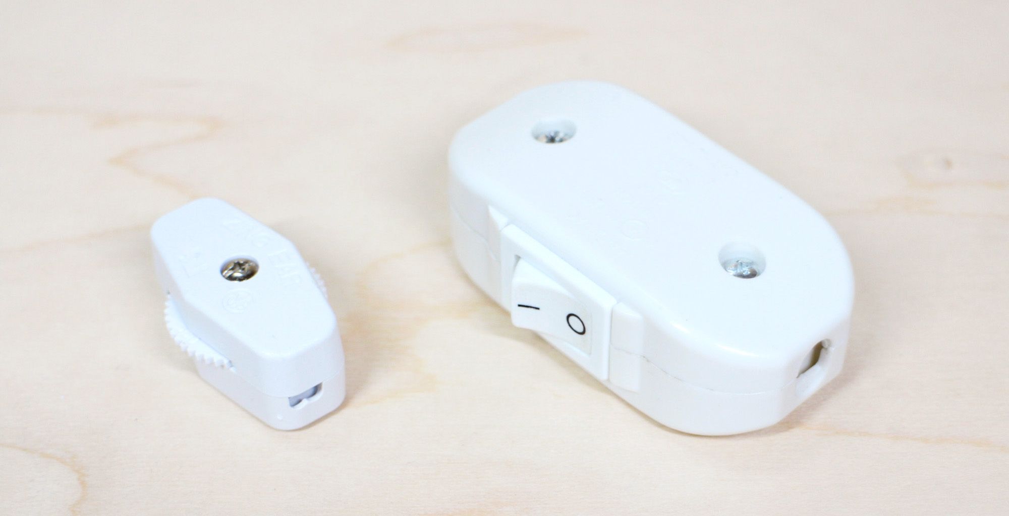

Switches
- 1 rotary single pole on/off line switch for SPT-1 cord
- 1 single pole rocker switch w/ screw terminal wire connections for use with SVT cord

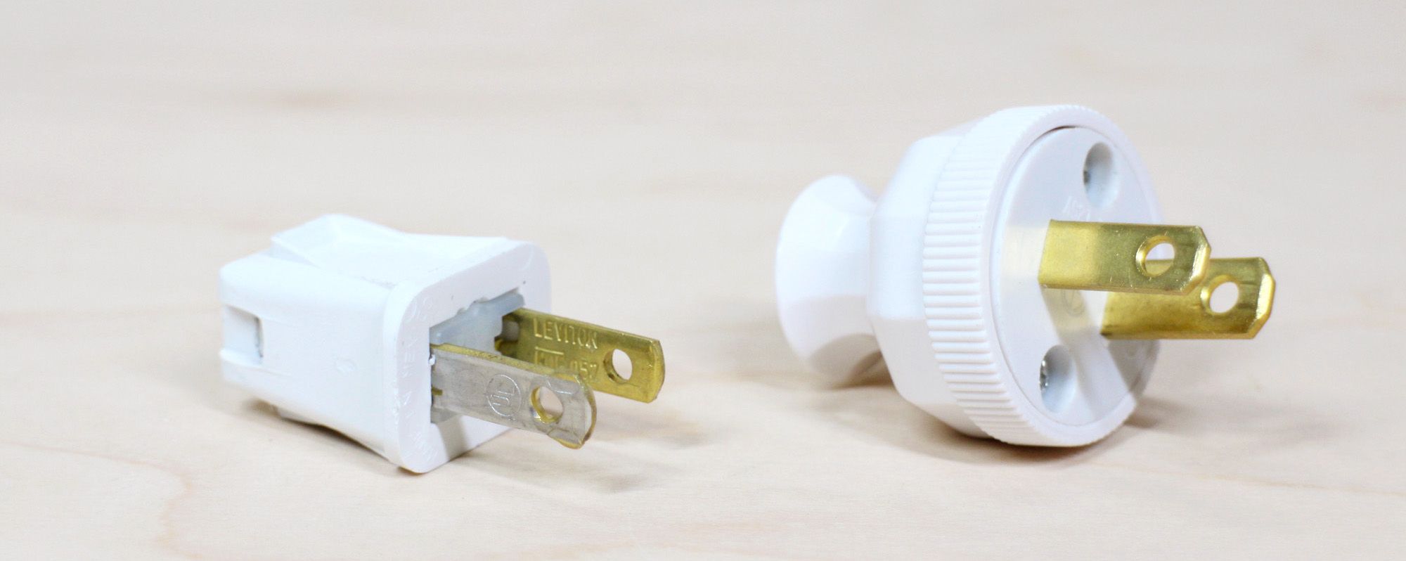

Plugs
- 1 polarized Leviton's Kwik Easy lamp plug or any easy plug for 18/2 SPT-1 wire
- 1 polarized antique reproduction lamp plug w/ screw terminal connections for use with 18/2 twisted and SVT cord, or 18/3 SVT cord

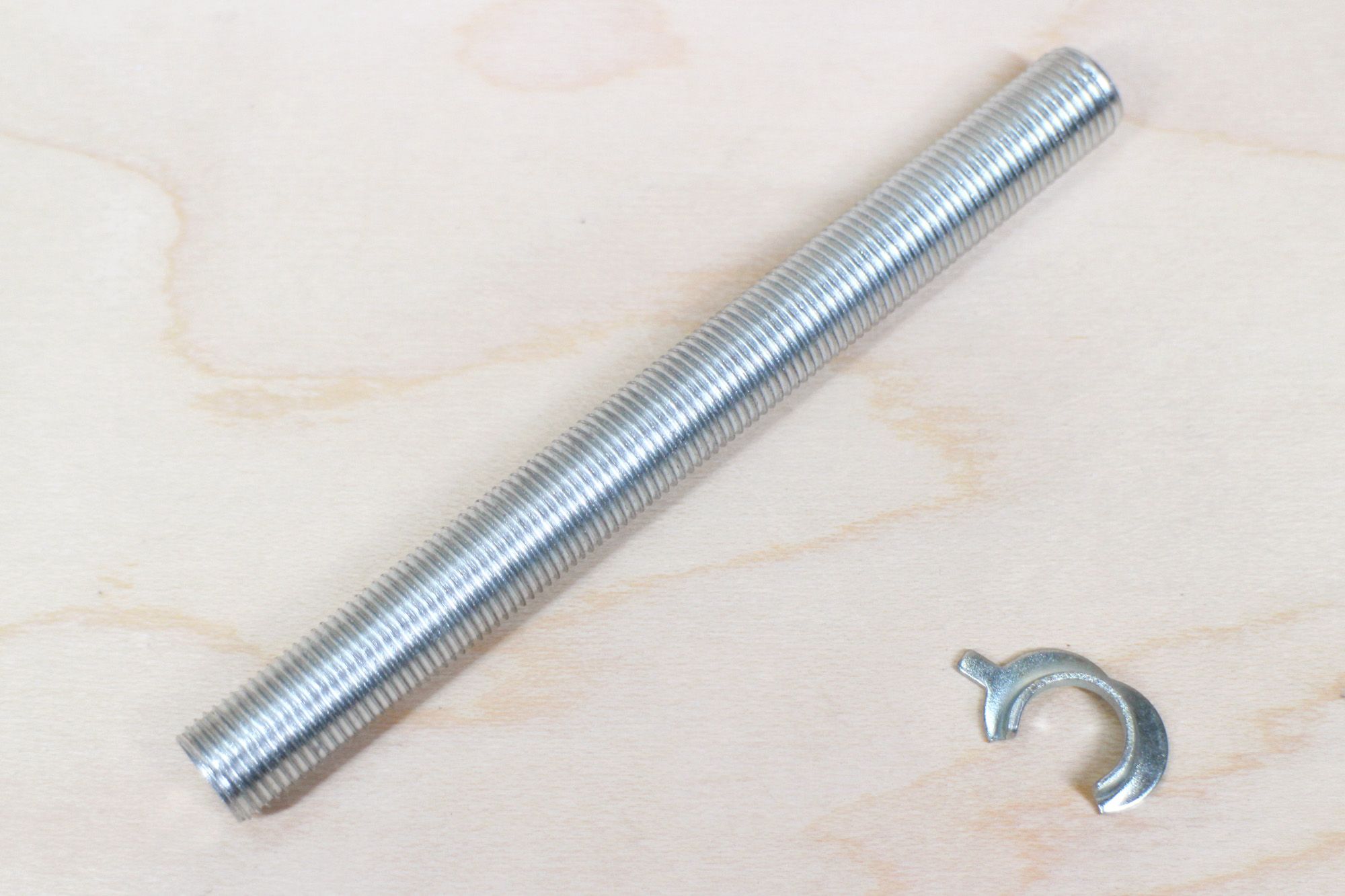

Hardware
- 1 threaded 1/8 IP nipple, 3-4" long
- 1 small metal strain relief

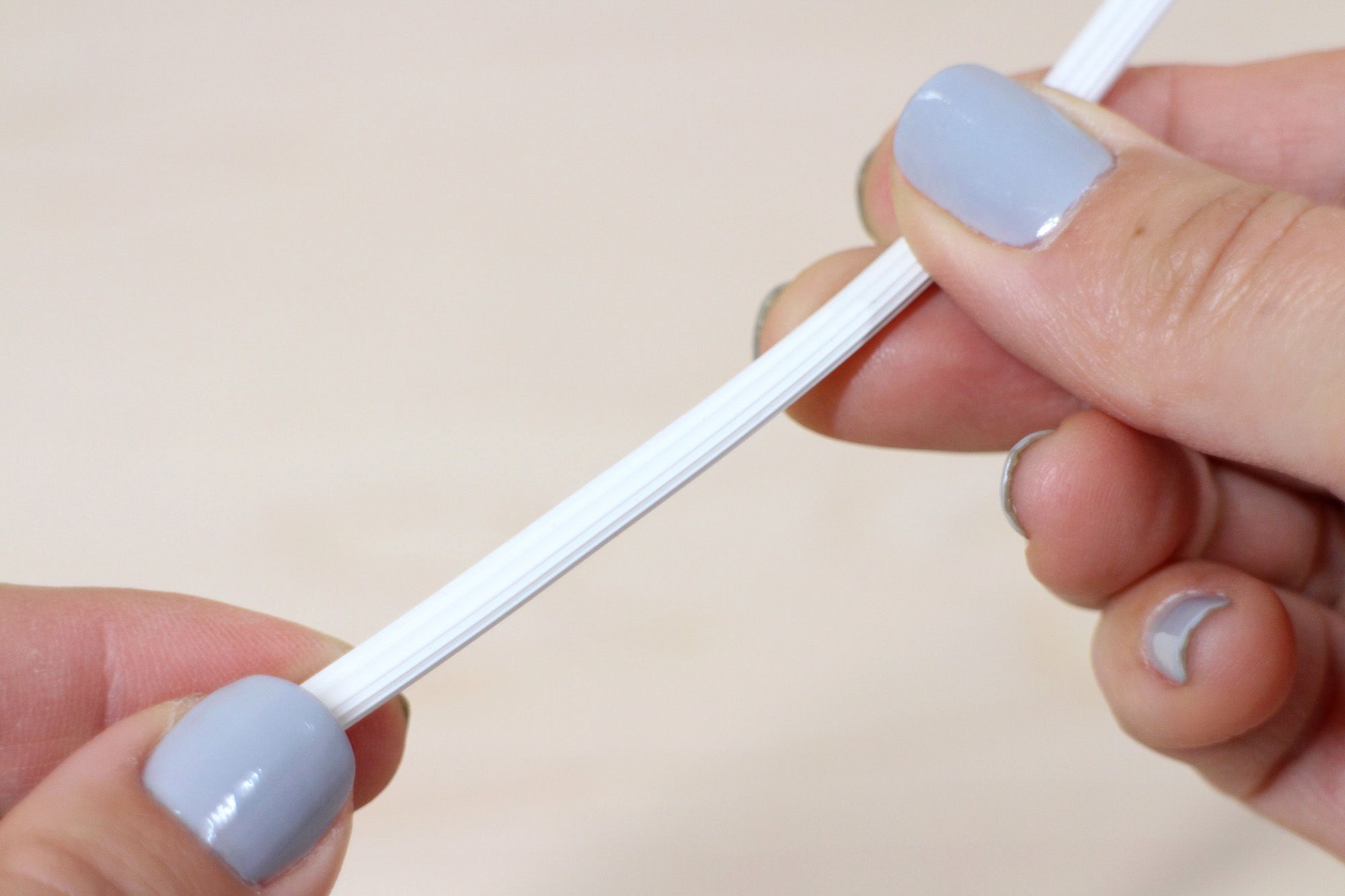

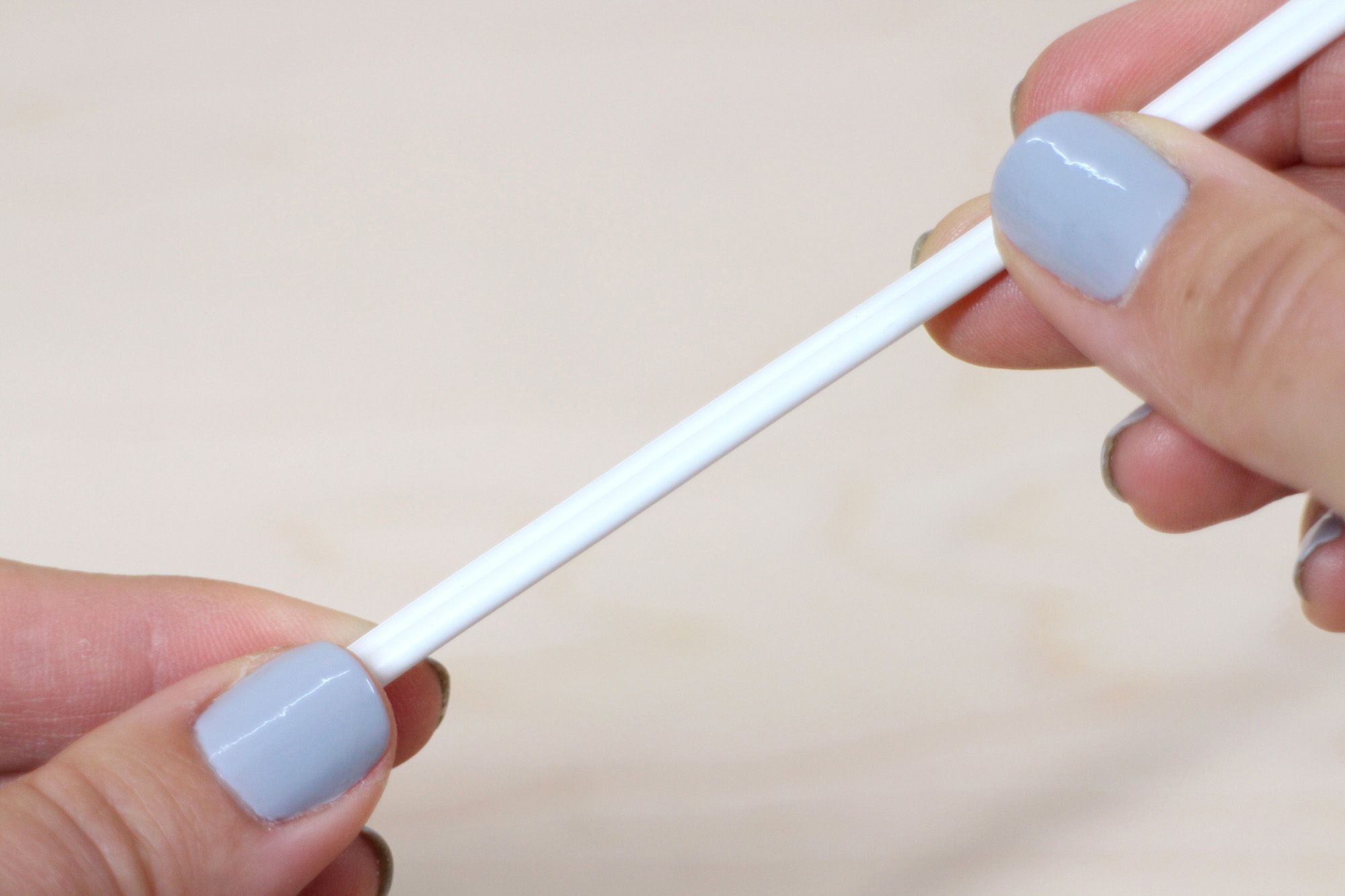

Step 9: Hot & Neutral Wires
The most important thing to know about lamp cord is how to tell the Hot wire from the Neutral. Why is it important to connect Hot and Neutral wires correctly?
When wired properly, the metal threads of a socket will never be “hot” or give you a shock, whether the switch is on or off. When wired incorrectly, the threads – and any metal touching the threads, including the outside of the socket, if it is conductive metal, or the threads of a light bulb – can give you a shock whether the switch is on or off. So for this reason, it's very important to follow the instructions for the Hot and Neutral wires carefully.
Which is which?
On both SPT wires, the Hot side of the insulating cover is smooth and the Neutral is ribbed or 'squared' with 2 ridges.
Smooth HOT Wire
Ribbed NEUTRAL Wire
On Twisted Cloth Covered, SVT, and SVT-B cords, the black wire is Hot and the white wire is Neutral. If you are using an 18/3 cord, the green wire is ground -- which is unnecessary for us to use -- and will get cut off when wiring the plugs and sockets.
