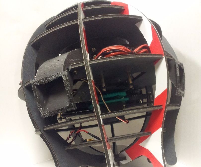

Step 2: Design and Fabrication
Now that we have our game plan, we gotten the cheapest brushless motor and controller that we could find (1200 KV, 20A ESC). To speed up our build so that we can meet the deadline, we used optomechanics parts from out optics lab to complete the build.We used a 9i n x9 in optical breadboard fro the base, although any base would do the job equally well. We then 3D printed mirror holders that are tilted 5 degrees from the rotation axis and stuck mirrors on them using superglue.
A problem we faced was how to continuously supply the green laser pointer with power. We one to retain the outer casing for mounting purposes. For this we decided the make copper cylinders using a lathe that is similar in dimensions to an AAA battery. We drill a small hole at the end of the cylinder for the cable. The cable was then passed though a small hole drilled to the back cover, allowing us to power the laser pointer continuously.
We also fabricated simple Arduino shields (eagle cad file and sketch attached) that would act the interface for the input audio signal and output servo control. We also included a LM317 voltage regulator that will provide the necessary 1.5V from a 12V power supply to power the laser pointer. We intial chose a small surface mount package for the LM317, but is overheat readily and go into thermal shutdown. Thus were forced to botch in a large package that can be attached to the heat sink.
We then laser cut 3 mm thick clear acrylic to make into a lid that is 9 in x 9 in x 2.5 in. Finally we lined the inside with foam to try to cut out some of the high frequency sound from the motors.
