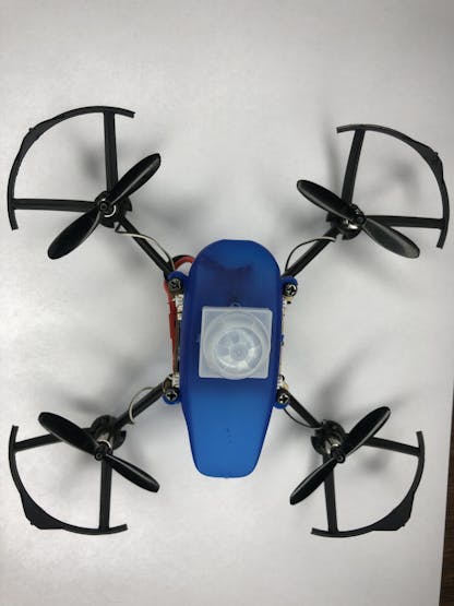

  • Pluto 1.2
  • Laser Reciever
  • Laser

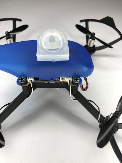

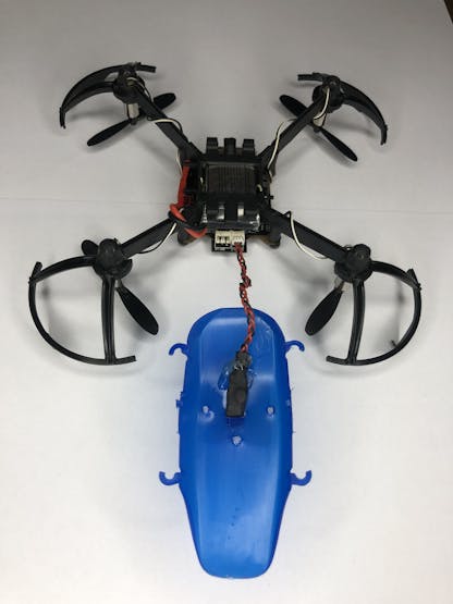

Step 1: Mounting & Connections
BOTTOM VIEW-
Step 2: GPIO PINS :-

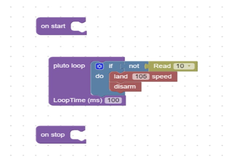

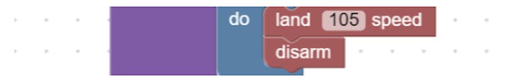

GPIO (General Purpose Input/Output) pins are a fundamental feature of many microcontrollers; these pins serve as flexible interfaces that can be configured to either input or output mode, allowing the microcontroller to interact with external devices and circuits. Similarly, the pin 10 is used as an interface between the Laser Tag Canopy and Pluto 1.2 flight controller, where the sensor values are transferred through.

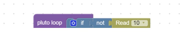

Further, we give a not value to this read command and feed it to the ‘if’ condition so that the ‘if’ condition is satisfied when the laser has tagged the drone.
Finally, when the condition is satisfied, we give the land and disarm command as an indicator that the drone has been hit and the player won.
