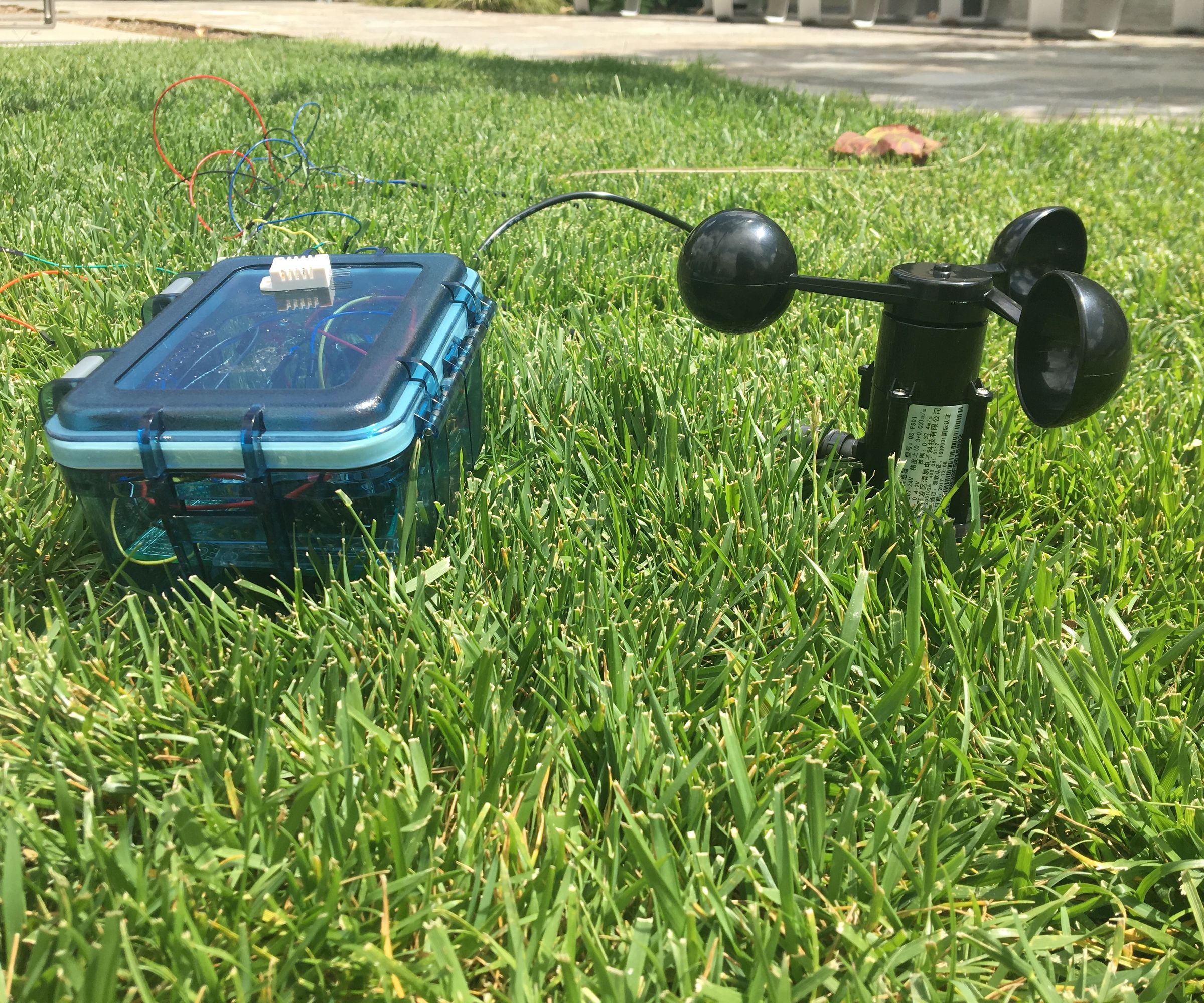

Our mobile station is equipped with the original contents of our station (minus the anemometer): an Arduino wired to a protoboard with a data logging shield, a DHT22 Temperature and Humidity sensor, and a BMP280 barometric pressure and altitude sensor. In addition to this, we added 2 cameras, different housing, and a few other extras which allow us to protect all of our sensors and cameras.

Start with a simple weather station such as one here with humidity, temperature, pressure, and wind sensors which log to an SD card all contained in a waterproof casing. **Note that it is important to use a 9V battery with the Arduino to power the circuitry. Since ours ended up dying early, we think that better insulation would be needed for extended data collection (although a larger power source could also be helpful).
For our purposes here, we'll need to disconnect the anemometer and remove our materials from the waterproof casing.

Your case is going to get buffeted by wind on the way up. It will then hit the ground at about 5m/s, so you need to make sure your sensors are securely attached to your protoboard. You'll also need to ensure that the temperature sensor is outside of your casing. This will allow it to record the actual conditions of its position, instead of logging the conditions inside the box, where there are heat warmers to keep other circuitry and cameras running.
