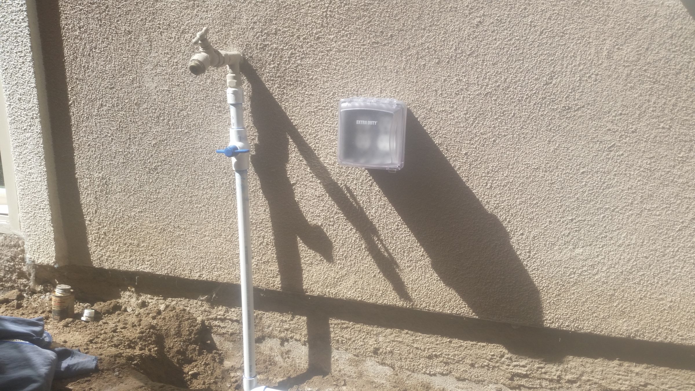

So, you removed all the bricks that you wanted to replace. WHOOOPI DOOO! Ok, now let's learn some actual skills.
So, now you have to figure out what to do. Every scenario is different and we will go over two.
1. What we found in photo 1. In the middle of the photo is recently poured concrete that I poured. It use to be sand and road base before, but I removed it. Outside my concrete hole is old concrete that was done from previous construction crews. I kept it, so I wouldn't have to pour even more concrete. However, the down side is I'll have to cut the brick's width down 1/2" to 3/4".
2. In photo 2, a pipe was installed underneath the ground. We were left with a giant hole. So, we filled it with concrete.

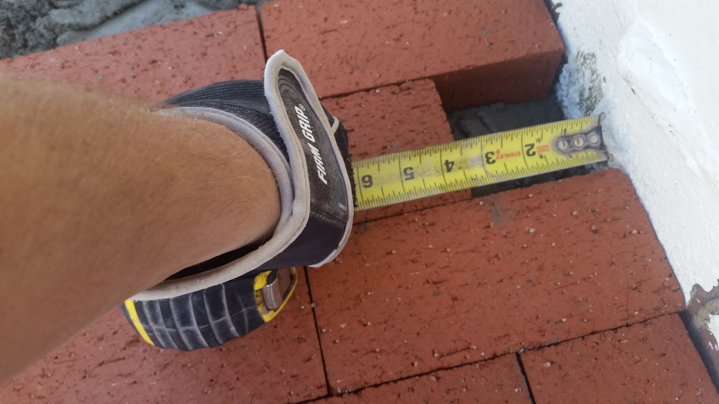

1. In example one, we measure from our brick to the building. Measure both sides of the brick. You'll want them fairly tight.
2. Mark your measurements on the brick. Take a carpenter's pencil and draw your line.
3. Use the grinder and cut on your line. You can continue to cut around the brick or take a circular saw and finish the remaining cut. If you have a brick saw then just make your cut like normal.
4. Place your cut into its place. Use the level and mallet to make it even with your fall.
5. Place all your cuts and your finish.
